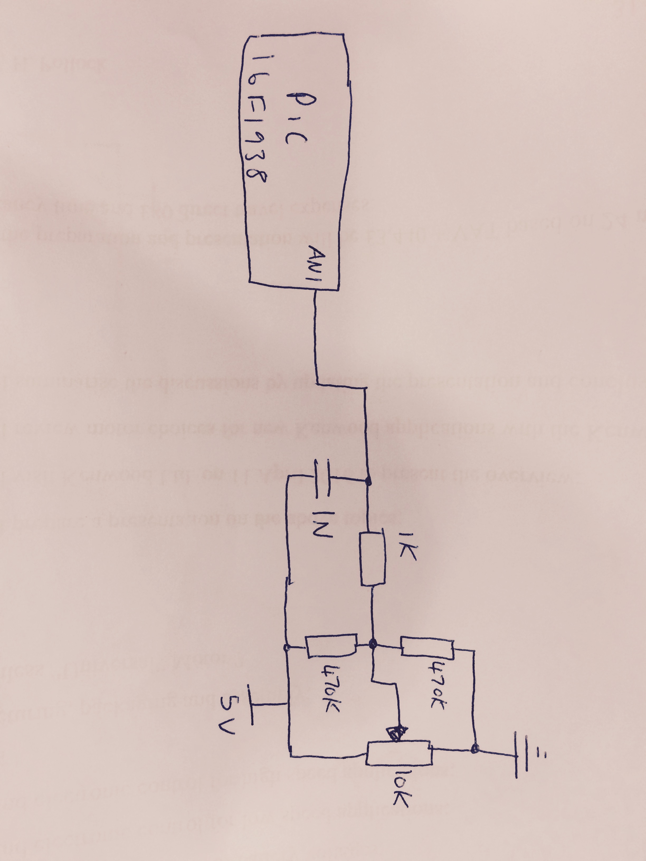

Firstly to summaries what i am about to say below, i basically want to mimic the signal that the pic receives from the potentiometer. I however want to leave this old circuit in there so the system can be controlled be input method A or input method B. The reason for doing this, is because i can't change the software on the PIC to use my input method B.
I have attached two images, "image1" is the circuit diagram of an the original circuit, which just provides the PIC with a input from a potentiometer.

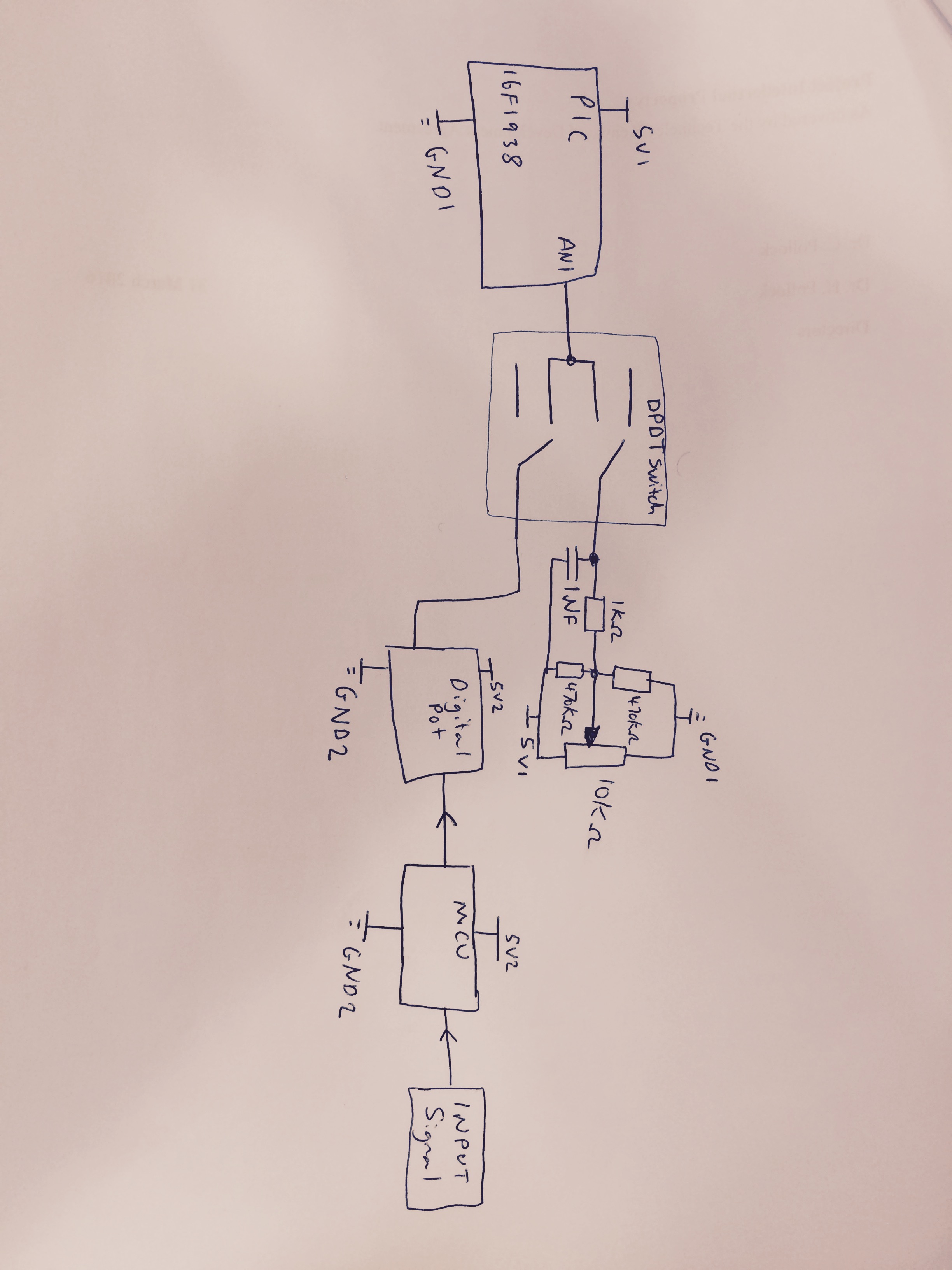

I also want to be able to choose between two input signal's to the PIC, my initial thoughts are provided in image2 which uses a DPDT switch to change between the two input methods. The second control method comprises of another MCU which has its own input signal, which then varies a digital pot proportionally to the input signal.
The problems that i face however is that the PIC and the second MCU must be isolated from each-other, as the PIC is attached to a larger system, and due to the fact they have different supply sources. I therefore need ideas of isolating the two systems and mimicing the signals.
Does anyone have any ideas? it would be appreciated, thanks!

I would just have said use a form C switch (not a DPDT).
However, does "must be isolated" mean that the PIC ground cannot be connected to the MCU ground? If so, then this is a much tougher problem.
Why do you think that you even need a digital pot? The PIC just gets a varying voltage (0V to 5V) at its ADC input that can come from filtered PWM or a DAC.

Yeah a form C switch will work. But as you queried it will not solve the isolation issue. I believe i need to use some form of opto-isolator or something similar but i am not too familiar with them.
I initially tried to use a low pass filter and PWM to mimic the same signal, i used a cap value of 1NF and a resistor of 470K to filter out the PWM frequency of 1kHz but the ADC readings where floating....

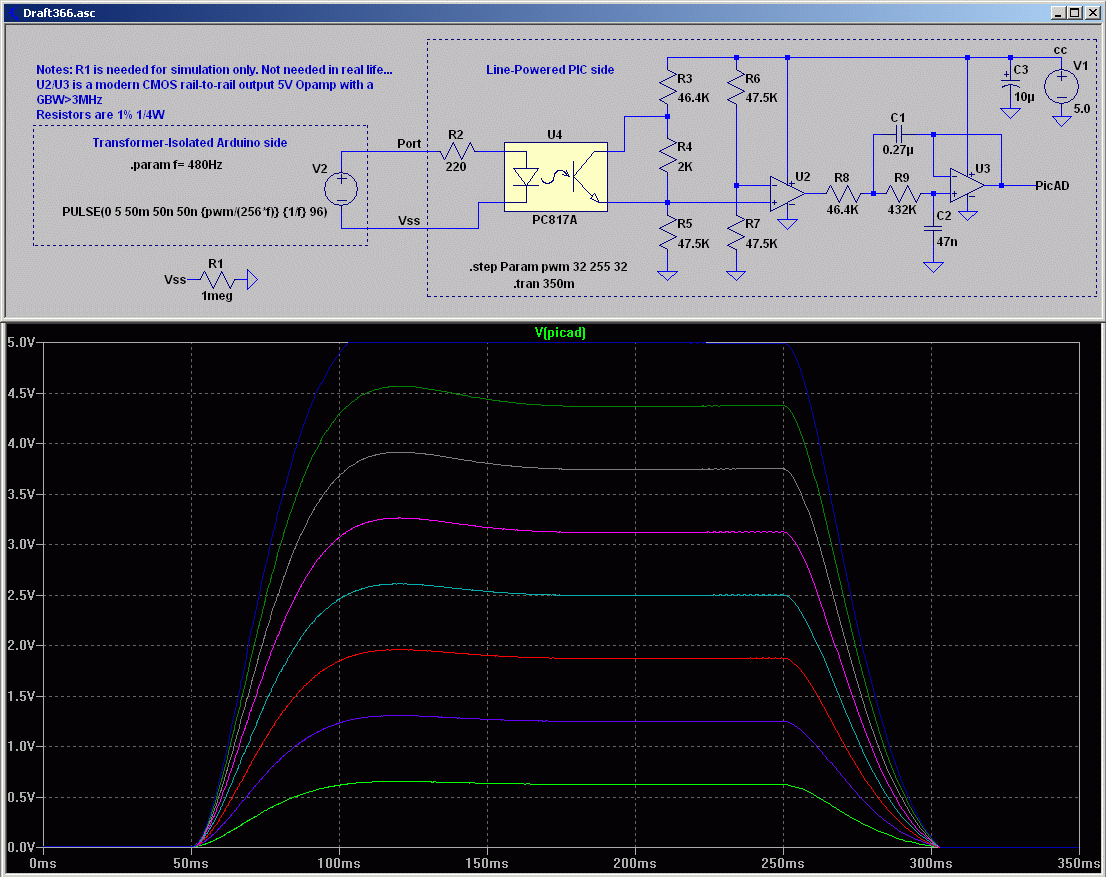

Here is my design:
Assumptions:
Full Opto-Isolation.
Arduino is powered on 5V.
You will use a 480Hz PWM Port on the Arduino.
The independent variable is the PWM value (0-255). You would like PWM=0 to produce 0V at the PIC's AD input. You would like PWM=255 to produce 5V at the Pic's input.
If you do a step change in PWM value, you would like the A/D input to settle in under a second.

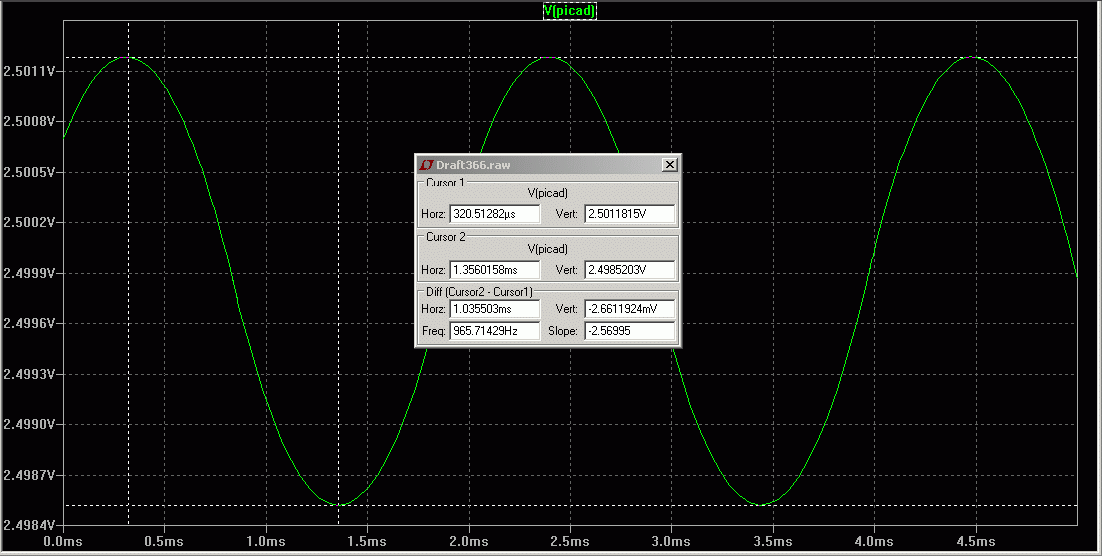

I show the settling time, the overshoot, the ripple, the final output voltage as the Arduino PWM value is changed from 0 to 32 back to 0, 0 to 64 back to 0,... 0 to 255 back to 0, at 50ms and 250ms, respectively. The AD out voltage that corresponds to PWM=32 is 5*32/256 = 0.625V, and so on...
Here is the worst case ripple (PWM=128):

To faithfully get the PWM signal from the isolated Arduino to the off-line PIC, the rise-time and fall-times of the PWM waveform must be matched, and the voltage swing must go from 0V to 5V.
My initial attempt used a simple resistive pull-up to +5V on the PC817, but the turn-off delay for full 5V swing was significantly longer than the turn-on time, distorting the width of the PWM pulse.
My solution was to come up with the Kluge consisting of R3 to R7 and U2. I am relying on U2's rail-to-rail output to create a (nearly) 0V to (nearly) 5V swing. By biasing the PC817 the way I did, it is now acting as a current switch, where its output voltage doesn't have to change very much (~200mV), and that (and U2) makes the turn-on and turn-off delays symmetrical, preserving the PWM information as it is optically transmitted.

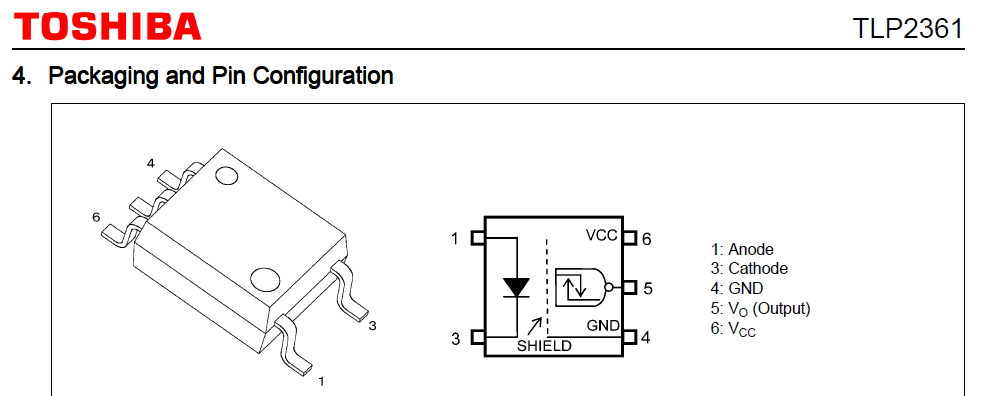

The TLP2361 is an open-collector NPN output with a 6.3mA sink rating. Using a resistor pull-up to 5V, it would have a Vce(sat) of ~0.4V when low, and would pull all the way to 5V when high, creating a different type of distortion to the PWM signal...
The TLP2200 has a full TTL-totem pole output, but doesn't pull any closer to ground than the TLP2361, and only pulls up to ~3.5V when high. If they where CMOS instead of TTL, they could work.
To use either one, it would require a "level restoring" circuit like U2. Does anybody have a CMOS "digital opto-coupler" suggestion that might work directly without U2?

Passing an analog signal through optical isolation is doable, but quite complicated and expensive. Since you can "communicate" the "pot setting" through a single digital channel using the Arduino's PWM, it just occurred to me to opto-isolate the single PWM signal, and do the conversion to a filtered voltage on the PIC side.
I set about "fixing" the poor results you got when trying to filter the PWM signal to convert it to a steady voltage. I have done this before, so I knew about using an active filter (2-pole, Low-Pass, Butterworth) with it's cutoff frequency set to about 10Hz to filter the 480Hz PWM to convert it into a level where the ripple would be less than 1 bit of noise to a 10bit A/D. You could use a single pole (RC) filter, but it would require an OpAmp buffer anyway, so why not make the filter 2-pole?
You could have placed the "digital pot" on the non-isolated PIC side, but it would have taken three opto-isolated digital channels so that the Arduino could talk to it.
I am attaching the LTSpice file so that you can play with it.
