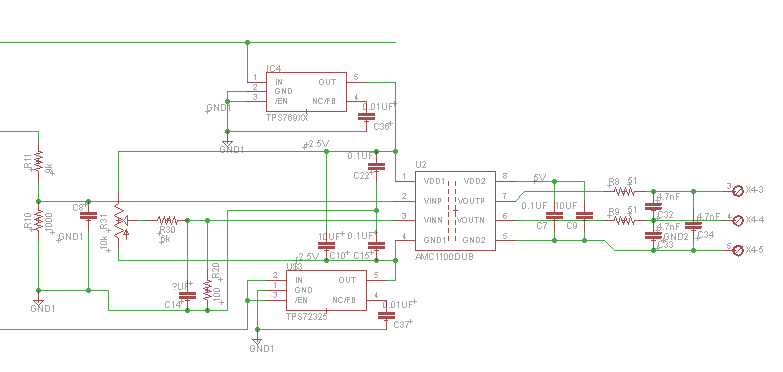

The last time I had to design an analog isolation amp:
AMC1100
Input +/-0.250V
output +/- 2.5V
It does a ADC conversion. Then pipes the digital across the isolation. Then back to analog DAC.

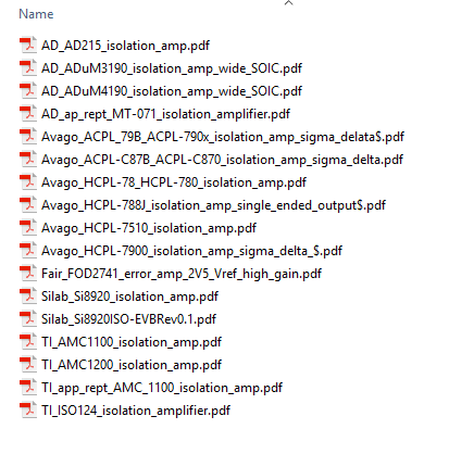

Interesting, I had a look at the AMC1100 and its brother the AMC1200. How did you get on with it. I couldn't get a definitive figure for the input current from the data sheet.
Avago have a large family of similar chips, all of which are primarily intended for current monitoring of motors, mains supplies etc, with input voltage ranges of either +-100mV or +- 200mV. Some are quite cheap, around £3 UK. The input offsets amounted to between 0.5% and about 2.5% which, coupled to other errors, seemed a bit high compared to a half decent opamp.
The precision isolation amps with higher input/output voltage ranges and lower input offsets from Analog Devices, for example, were heap big expensive: £25 UK upwards, so I dismissed them on cost grounds.
Here is the little list of isolation amplifiers that I examined. The HCPL-7900 seemed to be the best of the low cost versions with an input offset voltage of 0.5% of max input voltage.

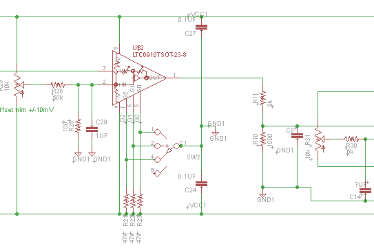

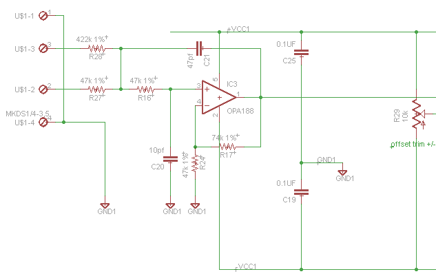

I tested one and then made the PCB. Got it back and lost funding. So the parts are in a box and noting is happening.
I sent the signal into the (+) input and put a pot on the (-) to do offset.
Ahead of the isolator I put a TLC6910 variable gain amp.
Because the isolator really does not like to see noise at the "switching frequency" I added a low pass filter with gain of 1 or 10.
So what is it? A isolated scope probe with a band with of 100khz. Gain knob and offset knob.
input stage

isolation:
There are two power supplies to make +/-2.5 volts for the isolator.
