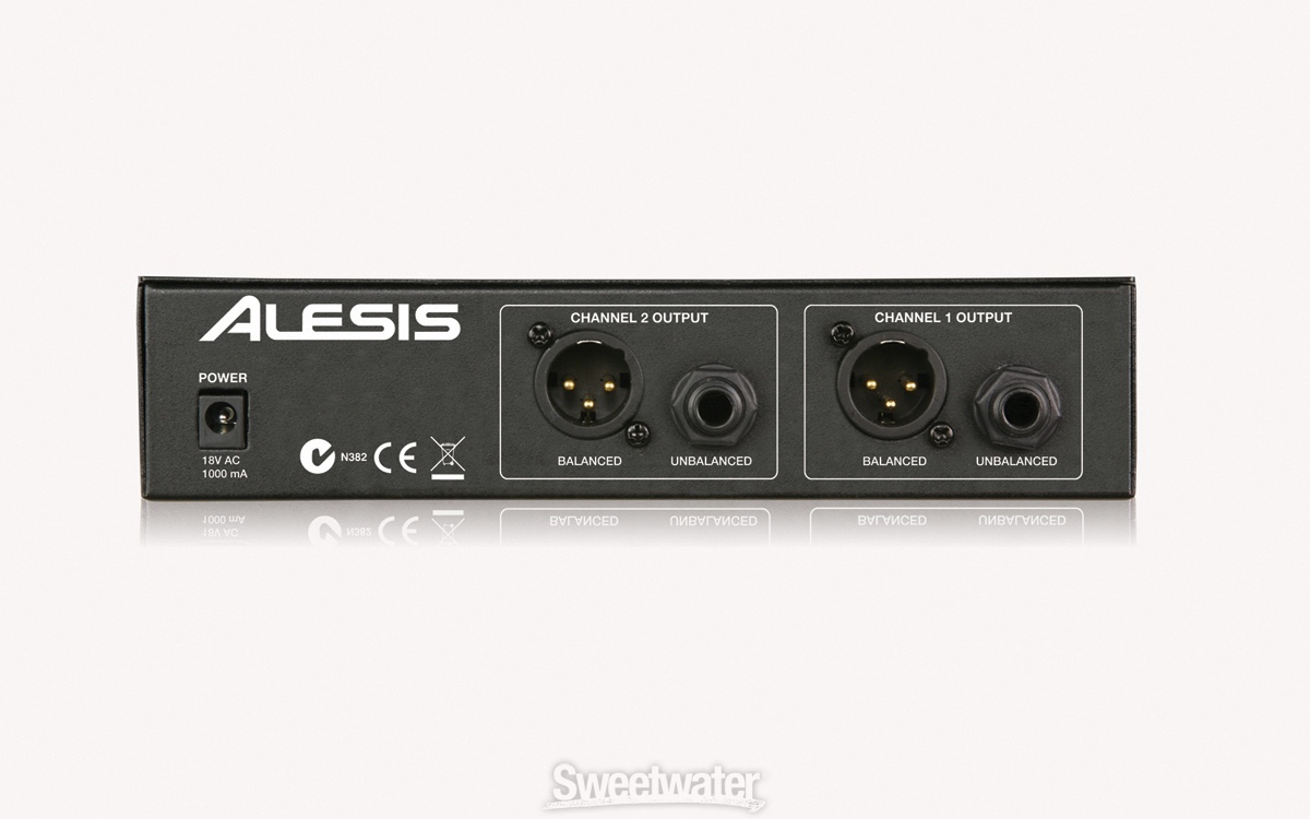

I am a musician, currently building a rack for live gigs. Some items in the rack come with wall warts. These are the ones I want to get rid off.
A couple of preamps operate at 9 VAC, 1Amp max; I ditched the two wall warts and replaced them with an overspec'ed transformer :
240 VAC > 9 VAC 4A X 2(dual). Total 72 VA. This is a heavy piece of metal, can be bolted or screwed on the wooden chassis. So far so good. Seems I could add 6 pres and use the same power source.
Problem is I'd liketo add a new (dual) pre which operates at 18VAC, 1 Amp max. Makes sense, since it has two channels...
The replacement transfo, being dual out, could provide 18 VAC/4A with a different wiring. But is there a way, maybe through isolation, to get both 9VAC and 18 VAC from this single transformer, ending up supplying AC power to all three preamps ?
Or whould you advise that I open the dual pre and see if I can manage to provide 9V to each channel ?
I must say I have no knowledge whatsoever in such matters : only thing I know is that I hate wall warts in my racks. I could get a second transfo but the first one is like having it kind of easy right now, at 2Ax9V max when it can do 8...
Appreciate any input, even discouraging or ironic... Maybe I'll have a clue afterwards :)

It's very difficult to tell from your description whether it would be possible to supply the various items from one transformer.
If you need to isolate, you might as well use separate transformers.
You should start off by finding whether the wall warts are regulated, and which connection, if any, is connected to signal ground. The AC input items are unlikely to need a regulated supply, but you can check by measuring the output of the wall wart with no load. If it is well above the nominal voltage then you don't need a regulator.
As for isolation, that is where it will probably fall down. It probably isn't going to work to connect multiple items to one transformer, because the ground connections will be connected though the audio leads, and the items have been designed around wall warts that are isolated.

That's AC. Pre's are from ART (model=Tube MP). The dual pre I'm planning to add is from Alesis and runs on 18V AC. Oddly enough, I also have an Axon guitar synth that wants 12 VAC. And the RME MULTIFACE could'nt care less whether you give her 12V AC or DC. I'm suspecting a pattern with bands heavy on the guitar here :)
Now I'm worried about that isolation thing.... Do you suspect I'm biting more than I can chew and would be better off reverting to the warts ?
I don't see any way of using two 9V windings to give both 9VAC and 18VAC without problems when ground leads are commoned.

Dual-pre newcomer wants 18 VAC as pictured here . At €68 I suspect the transfo to be a weak link,again. That's only me being suspicious, of course... Most people here probably know how paramount current production is, in analog audio.
Usually, I wouldn't try to second guess them audio gear manufacturers, in the matter of power supplies. Fact is, when I opened the Axon 12VAC wall wart (1.2A, mind you), I saw nothing but a couple of coils around an iron core... no specific isolation nor protection or regulation. This is when I thought that I could replace with a stronger, cooler, RACK FRIENDLY transfo. I just didn't look for fancier design; good, cause I know nothing about them !
My question was more like : should I dump the Art's (let them live outside the rack as DI's with wall warts) or could a dual tranny do for both 9V and 18V. I had my answer :) Got it, duly noted.
Now I have only this doubt remaining (hair on the neck): was I correct using a single dual out tranny (2X 9Vac X 4A), 4 wires outs as two separate 9V transformers, or should I have stayed with two separate ones, like the original wall warts ? Is it because of the ground meeting back in the audio chain ? After all, all wall warts in the rack do share the mains including ground, was my idea... Now I suspect I sound silly again. Oh well...
When the 18V Alesis comes in, I will inspect the supplied transformer (low hopes at €68) and probably replace it with the overspec'ed 72 VA already in the rack. That is until I investigate these toroidal, cool, quiet, low footprint, low emissions trannies... How seductive are these... or is it me overstating clean and cool energy in an audio chain ?

You can't wire it to have 2 x 9VAC plus 1 x 18VAC as that will short the transformer via the rectifiers in the amps. You have to do 1 x 9VAC + 1 x 18VAC. The 2 9V preamps have to use the same winding.
It is fairly common in small audio equipment to generate both positive and negative 12 volts DC from a single 9V AC winding. They tie one side of the the winding to gnd, and the other side goes to the the anode of one diode, and cathode of a second diode. Add a cap to each of those and you've got +/- 12 volts. In many cases, they aren't even regulated, trusting that the PSRR of the op-amps won't pass any of the power supply ripple.
That's still iffy business, I think. The rectifiers in the amps may be grounded to the shields/enclosures/whatnot and if the grounds from the different amps get connected somehow, through the I/O cables, for example, the results might not be pretty. If going this route, I would definitely take a good, hard look at how the rectifiers are wired and, if necessary, make sure the ground/enclosure/cable shields of each amp are electrically insulated from all the other amps/cables connected to that xformer. Am I missing something here?
