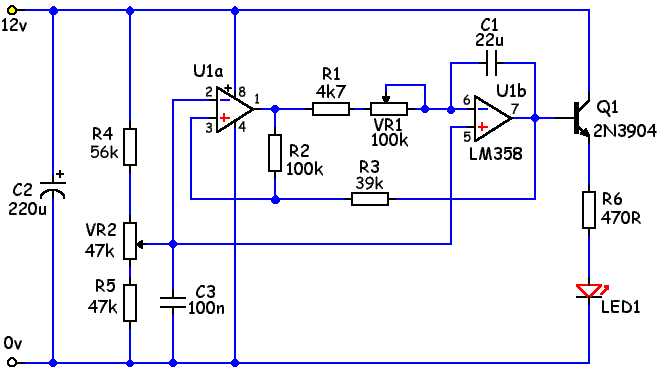

Let's say a guy wanted to build this circuit (the famous "LED throbber"):

The only part of the circuit I'm concerned with here is this:
So since I can't "add" a negative voltage to the base, I'd want to make the emitter more positive with respect to the base, which would have the same effect, right? So how would I do that?
Note: Please don't respond by telling me there's a better way to do this. My goal here is not to start a production line of widgets with throbbing LEDs; my aim is to learn an electronic principle. So humor me and let me do it this way, even if this is the most ridiculous possible route, OK?
By the way, even though the author of the circuit gives us a variable "virtual ground", I don't think this will work to bring the triangle wave below zero, will it?

Well one way would be to use bipolar supplies, so that the emitter would return to some negative V-.
PS I think VR2 in your circuit can be adjusted to translate the voltage the way you want, if you were using bipolar supplies.
OK, that's one way, but not the way I want to do it. Any way to do it with a single supply? I ASS-U-ME I just need to make the base swing negative with respect to the emitter here.
That would cut the transistor off. But you can't do that unless you have bipolar supplies. The emitter returns to ground, and you cant get more negative than that. In fact, you won't even be able to generate a negative going pulse with the single supply. But... you can use a resistive divider to make the emitter return to Vcc/2.

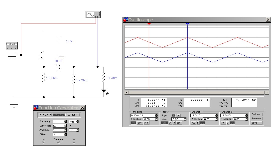

OK, like this?
I'm still mystified how one can get a negative-going voltage out of this. Is this because of the capacitor discharging during the bottom part of the waveform?
OK, like this?
You need a transistor bias resistor from the emitter to ground. With the capacitor as you show there is no DC path for the transistor current.
Since the cap output average is zero then any output signal through the cap has to have an average output of zero. For a symmetrical triangle wave the average is 1/2 the pp voltage. See circuit below.
It works!
Here's what I ended up with:
I know it's going negative because both LEDs pulse (alternately, of course).
Thanks! You're a gentleman and a scholar.
Now, of course, I want tweaks. Never satisfied.
I can tell by the behavior of the LEDs that they're underpowered and are only lighting at the very peaks of the waveform. So I need more volts, man. (Larger peak-to-peak swing.)
How can I get this? Different resistor values? or how about another transistor in there? (Darlington pair?) Can you cook me up a quick circuit fix? (If you're wondering what transistor I used, it's one I grabbed from my junk box. Looks like a Motorola piece, marked "7128/644". Maybe I should use a different xistor?)

It would help if we knew the value of V+ and the signal voltage at the transistor base.
Since you have added an extra LED you can remove the 1k resistor in parallel. That may increase the output some.
Don't forget that the first couple of volts or so that is across the LED's will be lost until Vf is reached.
With a supply of 9 volts, I get a base voltage swing of 4.5 to 6.2V.
With a supply of 15 volts, I get about 7 to 9.5V.
I'd like to be able to run this off a 9-volt battery.
Obviously, this transistor stage isn't working too well. I'd like suggestions on how to improve it.

Did, but it didn't make much difference.
What is generating the base voltage? 7 to 9.5V gives you only a 2.5Vpp signal so I'm not surprised you can barely see the LEDs light.
A Darlington won't help since you need to a higher voltage swing and a Darlington follower has a slightly lower gain than a single-stage emitter follower.
Certainly a common-emitter stage driving the emitter follower should help if you bias it properly. Without seeing your circuit I can't help you there.
