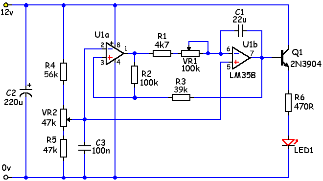

Since the LED current is very low and can be driven from the output of the opamp then remove the transistor.
I don't see the point of converting the original fading and brightening LEDs circuit into this circuit where the LEDs simply turn off then flash on. The triangle waveform is not used anymore when the capacitor is blinking the LEDs.
The complete circuit (the LED throbber) is attached below, plus my modifications, shown above. (Simple op-amp triangle-wave generator.)

According to my simulations, increasing the value of R3 will increase the amplitude of the output. You might try going from 39k to 60-80k and see what happens.
Edit: If you want to experiment with circuits it's a lot easier to simulate them before you build them to understand and optimize their design. LTspice form Linear Technology is free and works well.
I did that, and it made a remarkable difference. Much higher voltage swing. Now the LEDs light fairly brightly from a 9-volt supply. Thanks!

So I cobbled this together:
It works--sort of. It only lights one LED, so I ASS-U-ME that I'm getting the waveforms indicated above. (I'm sure about the second one, the one that's both positive and negative, because both LEDs light alternately.) So obviously, something's wrong. My nice symmetrical signal (from the emitter of Q1) is getting polarized, the opposite of what I want. What I want to do is to light both LEDs equally and brightly.
I'm sure my biasing is totally wrong, which may account for part (all?) of the problem.
Any help would be appreciated. To reiterate, this is not a matter of coming up with the optimum circuit here. This is a learning exercise for me, and hopefully for any other poor souls who might come this way with questions about biasing and other great existential matters.
Ideally, I'd be able to do this with one transistor. I just tried this to see what would happen.
Your second transistor has no base bias. It will only conduct on the rising pulse. You won't get both LED's to work that way anyway. If you want to see both flash, connect one between VCC and the collector of the 2nd bjt, with a series resistor of course. That way one will illuminate when the transistor is on, and the other will illuminate with the transistor is off. There is no other way to get both to flash in the way they are connected.
The original circuit does not use an output coupling capacitor so its LED brightens slowly and dims slowly by a variable DC voltage (the triangle waveform).
Your output capacitor feeds AC to the output transistor but it doesn't work with AC because when its base goes less than 0.6V or goes negative then it cuts off, it needs a variable DC input voltage.
If you bias the opamps properly then you can get the NPN transistor to brighten an LED at the same time that a PNP transistor dims another LED and they alternate.

The emitter-follower transistor linearly pulls its output voltage up with the triangle input waveform.
But only one of the 1k resistors pulls the output voltage down so the voltage to the LED is not symmetrical. The circuit needs a push-pull output pair of transistors to do what you want.
Guess what? The output of a 555 is push-pull and will do what you want without a transistor. The max output of an ordinary 555 is 200mA but the Cmos 555 output current is much less.

Because the output was capacitively coupled, the current was truly AC. In the last case, using a capacitor between the two transistors doesn't make the output AC, instead it's a pulsed DC.
Since it's certainly possible for an amplifier (a properly-biased one, at any rate) to reproduce an AC waveform, I'd like to know how I could do that here. Again, for the sake of learning, not because this is the best way to accomplish this simple task.
It's possible if the output is capacitively coupled, or a push-pull topography is used with split supplies. Otherwise, the output rides in a DC level.
