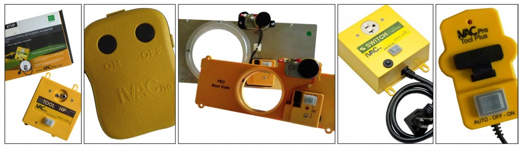

Interesting products: https://www.amazon.com/iVAC-10031-010-Automated-Vacuum-Switch/dp/B0035YGLZG
Some reviews. https://www.woodcraft.com/products/ivac-automated-shop-vacuum-switch# Some negative, it is sold in the uk.

ivac responded to some of my questions and liked some of my ideas;
1. not intended to keep the vac operating when switching tools. e.g. using belt sander and then change the blade in a jigsaw before using the jig saw.
2. the magnetic switch can be used on battery powered tools. It senses the magnetic field. The minimum sensed current for the tool is 0.5A.
3. the sensor opens the gate and the gate turns on the dust collector. Makes sense..
4. I suggested instead of one specific gate open, to use last gate and they might consider the suggestion.
5. Another response:
A LED on the blast gate would show that it has been given the command to close which essentially means the dust collector has been given the command to stop. If the dust collector does stop, the gate last used stays open. it would only close if another tool is turned on or commanded by the remote to open a blast gate.
I will add this idea to the wish list for consideration.
