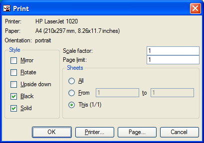

I've been using Eagle for the layout of my projects for years, but the problem is always with me. In the layout editor, the pads are usually green in color. When I print it out in black and white, I found that the pads are in grey and the tracks are in black. The grey color can pass though the UV light partially. So is there any setting can be done to make it to be completely dark?

?? What black and solid boxes??
FILE>PRINT brings up the dialog box shown in the attachment.
Oh god, I never notice them. Actually my friend reminded me that the layout I printed out is not solid dark, I didn't care about that too. Usually I just print as default.
So after checking these boxes I will be able to get solid black?
Thanks :)
