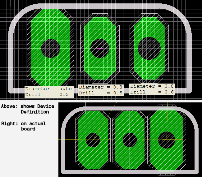

Hi
since this thread appears to have a number of Eagle queries, does anyone have any idea why I am getting odd pad sizes ?
Basically, I have defined an e-line transistor device which has quite close pads (1.27mm apart). In the device definition, they appear correct, but when used on a board, it looks like the diameter is being ignored and always uses auto (I have done a library update). I am using 4.16
Have I missed something obvious ?
Mike
