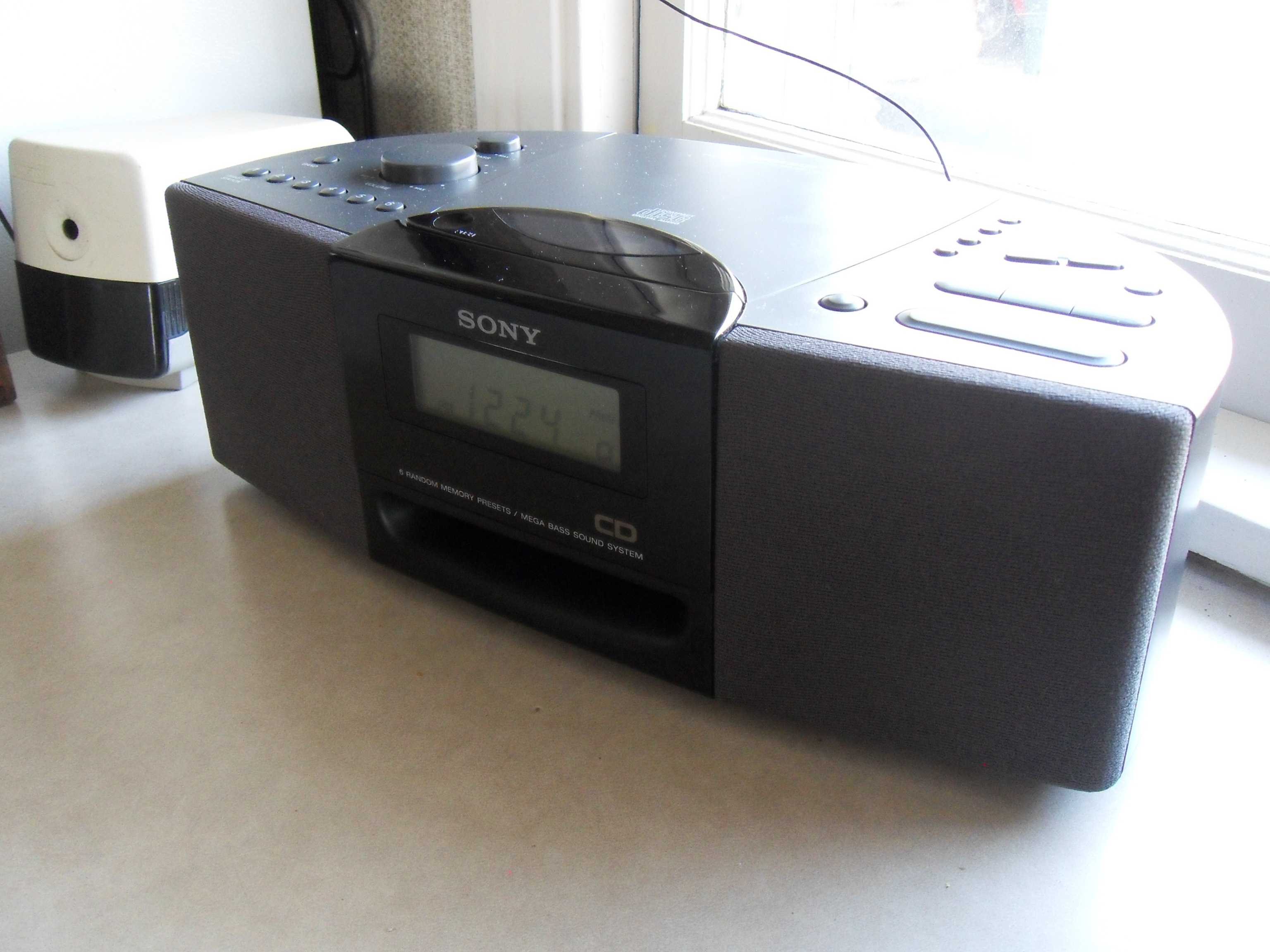

Here's the Sony CD/AM/FM. Two main 3.5 inch speakers and a rear 4.0 inch "sub" woofer.

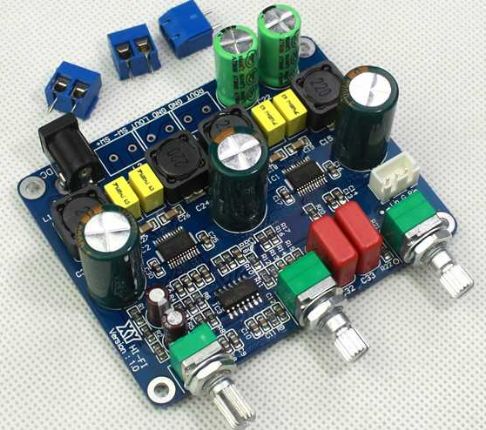

The new Amp
![21amp_zps347d1bbe.jpg 21amp_zps347d1bbe.jpg](https://www.electro-tech-online.com/data/attachments/53/53087-528813ee40896c29d32a9ffe0735522f.jpg)
And the page I purchased it from....
It's 10x the sound quality of the existing amp in the Sony.

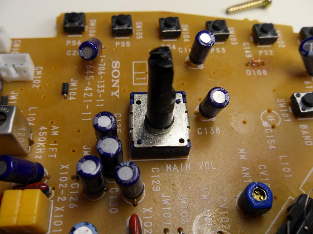

I'm controlling the amp above right off of the preamp board in the Sony
![SDC14750_zps81cf6111.jpg SDC14750_zps81cf6111.jpg](https://www.electro-tech-online.com/data/attachments/53/53088-7465701a61b16d9c55cad26884d153ab.jpg)
...tapping into the main volume pins on the bottom side.

As to the current requirements. The amplifier vendor provides nothing specific on this, but suggests a 15 to 20vdc SMPS to drive the amp. SMPS sold online for this size chip amp are commonly 2.0 amps.

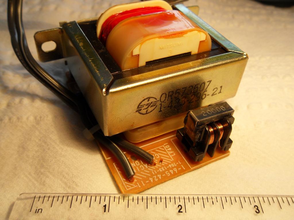

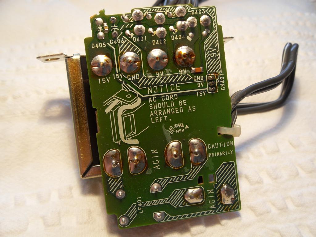

The onboard linear xformer.
![SDC14758_zps30150547.jpg SDC14758_zps30150547.jpg](https://www.electro-tech-online.com/data/attachments/53/53090-86420bbbb0c9486cfb9d01feb03e9e81.jpg)
![SDC14753_zps4e6bdaaf.jpg SDC14753_zps4e6bdaaf.jpg](https://www.electro-tech-online.com/data/attachments/53/53091-e8bf749c08ec14f805bdefad91a1df67.jpg)
I could just leave it in there. But then I'd have to keep the 120 cord connected and try to mount the SMPS in the radio. No room for that.
I'd prefer to connect to the radio with the single 19.5vdc cord. The OEM xformer has 9 and 15vdc clearly marked outputs. I can connect directly to the new amp with 19.5vdc and then feed the 9 and 15 volt and ground wires leading out of the old xformer.
Would the circuit required for stepping down and splitting these voltages be complicated with various IC regulators and such?
