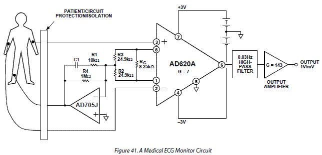

Hey guys,
I am trying to build an ECG amplifier with 3 electrodes. I am using AD620 as the instrumentation amplifier. I built the ECG circuit shown in this link on page 15: https://www.electro-tech-online.com/custompdfs/2009/01/AD620.pdf
with a few modifications made to the right-leg driver circuit.
I didn't use C1 and R4. My right-leg driver circuit just has R1 = 50 Ohms and R2=R3=100 Ohms and LM741 as the op-amp. I removed C1 and R4 because I wasn't really sure why they were there. Our circuit is not working, all we see is noise. We placed two electrodes on the chest and one on the right wrist. Could someone please help me with this? Is there a better ECG circuit or could someone explain what exactly the right-leg driver circuit should have?
Thanks!
C1 and R4 are crucial feedback components, don't leave them out - and don't use a crappy 741, use the opamp they suggest (741's are as low a spec as they come, pretty well).
How do I choose the values of C1 and R4?
Why do you want to deviate from the schematic values for any of the components? The values were selected for a good reason. Unless you really know what you are doing, you generally don't want to deviate from the given values.
You pick arbitrary values for some of the components (some of which are several orders of magnitude different from the assigned) leave out others, and then wonder why the circuit doesn't work. Is that really a suprise?
Use the assigned values, add all the parts back in the circuit, and then let us know how it's operating.
I'll be surprised if your circuit is working. R4 is a key part for the driver circuit. it's the feedback resistor of the amplifer circuit. without R4 the gain of the driving circuit is very low. 741 isn't a smart choice for applications like ECG. noisy, low open loop gain, low input impedance, high drift... The only virtue of 741 is it's price.

The datasheet for the AD705 opamp shows that its max input offset voltage is less than 1/100 times the max input offset voltage of ordinary cheap opamps. Its gain is very high so an ordinary opamp will amplify its own input offset voltage and then be saturated.
The right leg driver cancels DC and low frequency common-mode voltages that both inputs pickup so that the instrumentation amp is not saturated. The 24.9k resistors must be matched.
The highpass filter is used at the output so that a DC offset voltage is not amplified. Of course a lowpass filter is also used to reduce noise.

please explain the working of ad 705 connected to leg driver .what is its function ?
what are the role played by the R1 and c4 ?
basically what leg driver will do?

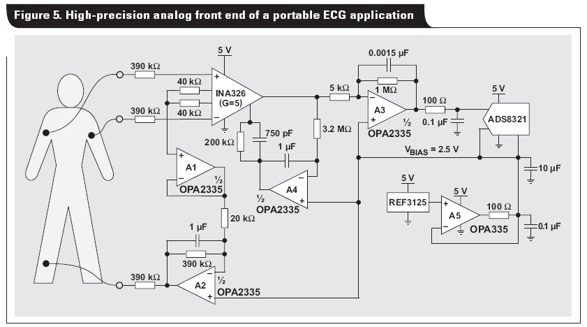

Here is another ECG circuit that uses the right leg for cancelling the DC and very low frequency common-mode voltages:
Opamp A5 is a buffer with a very low output impedance for the 2.5V reference voltage.
...which is serving as the ground reference voltage for the signals. Your power supply ground looks like -2.5V (or -3V in the original circuit) to the amplifiers.

For the attached RLD ... the 24.9k (R3 and R2) resistors are used for what and they do not in any way affect the gain right of AD620 right? Secondly, can R3 and R2 can be any values ... like 290 ohms?
