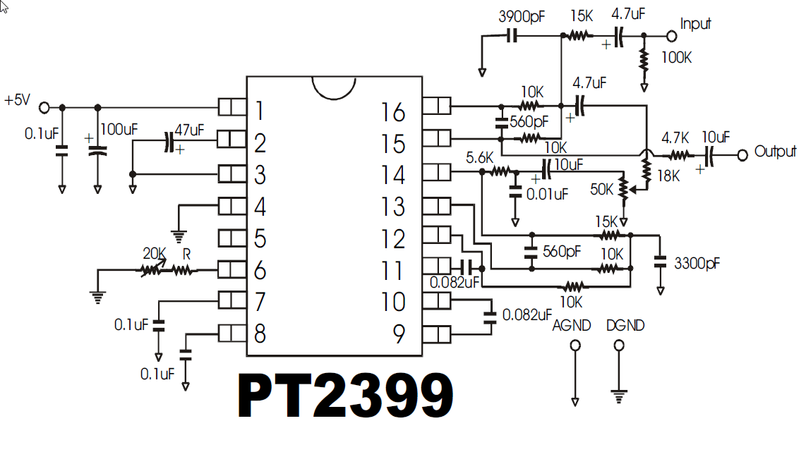

I have a Echo Processor IC PT2399, on the data sheet they have A Ground & D Ground Symbols on one of the Schematics. ATTACHED.
Could someone help me out with this as I don't fully understand the grounding for the circuit.
I have breadboarded the circuit & have The D Ground symbols to Battery Ground & the A ground Symbols to a rail of their own--basically all connected together but not to the Battery ground.

Think of A ground as a clean reference. Think of D ground as a dirty ground where the absolute reference is less important.
A ground an D ground should be kept separate until they are joined together where the power supply reference is. They can be isolated a bit using LR filters. If the chassis is the ground, then the signal inputs and output grounds can be connected to chassis via small resistors (2-10 ohms). This helps to reduce ground loops.

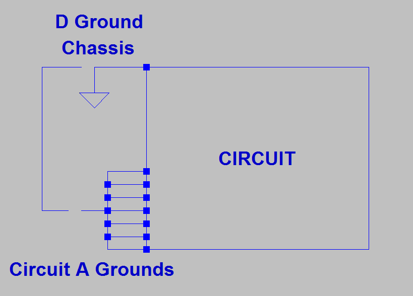

Ok, I have attached a quick drawing with the grounding to make sure I have it right.
The attachment shows a rough square representing the circuit & shows the D ground Battery-Chassis ground top Left, the bottom Left shows the Circuit A Grounds.
I have drawn a line to the Left that is not connected, is this where I should connect the A grounds to the D ground. I think this is what you meant?

I only see the one digital ground. The important thing is that the digital ground current doesn't flow through the analog ground. So.. At the point where the power enters the box make a point called ground. Pin 4 (digital ground) should have its own wire to this point. Hook all the analog grounds together trying to use pin 3 as a reference point and bring another wire back to the same point called ground. The .1 and 100ufd caps should be close to pins 1 and 3.
Yep, went to sleep. There are 2 digital grounds. One on pin #4 and one near pin #6. As ronv said, currents through that ground should not flow through any of the analog ground paths.

So, I have the A Ground Plane & D Ground Plane seperate & I connect these together at a single common point.
There is a 100uF PS Cap, is this a good place to join both ground planes?

Join the grounds at power supply common. Two wires to a lug on the case is somewhat ideal.
