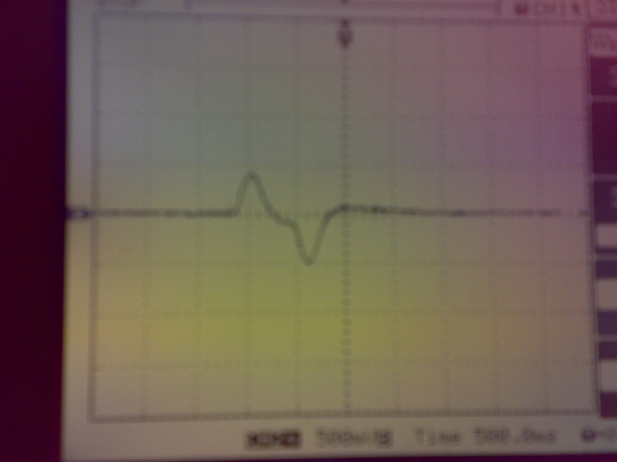

hello people...
finally i got outputs on my eye based project for which i wish to thank all members for their help...
at the output of the circuit designed, i get two waveforms as the result... (i apologise for the rather shoddy images)..

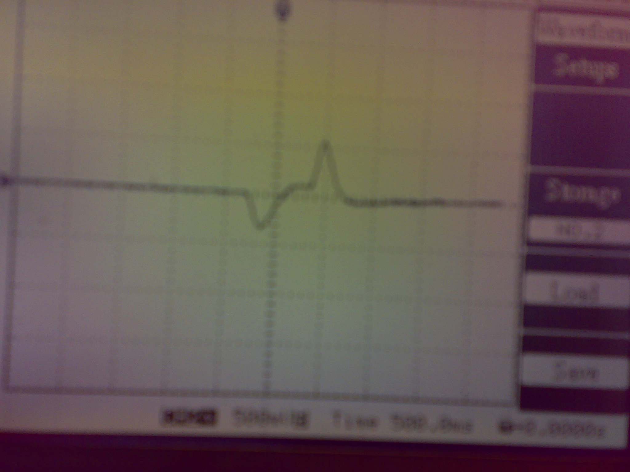

(1) one for moving eyes to right and coming back to centre. (refer image1)
(2) one for moving eyes to LEFT and coming back to centre. (refer image2)
as u can see the 2 waveforms are symmetric....
moving right is assosciated with a RISING edge first, whereas moving left is assosciated with a FALLING edge first...
is there any way by which i can differentiate these movments???

You could have two comparators wired so that one detects "less than zero" and the other detects "greater than zero" and then only respond when the comparators trigger in the right order within a certain time limit. THis would take two pins and some coding.

thanks for the reply...
if u see image1, the output first goes high (as the eyes move right), then falls down (as the eye comes back from right to centre) and reaches a constant level...
if i use a comparator, then i detect greater than 0 first and i do some operation, but as the coltage then falls less than 0, the comparator will do the other opeartion also rite?? i do not want this...

That's why you need two comparators to detect both the rise and fall, and use or combination+timer logic to produce the output you want.
A D-flip flop captures a logic value on the rising edge of the clock I believe. I don't have time right now to think about it too much but if you placed an inverter in front of the clock pin of a DFF then it would capture a signal on the falling edge. You can set the "signal to be captured" to be 1 when you are searching for a signal and reset the DFFs after you have found it. You'd need other circuitry to figure out which DFF triggered first to find direction.
Are you realy interested in detecthing the symmetry of the rising/falling edge, and then detecting the falling/rising edge? Or are you fine with just detecting the first rising edge, or the first falling edge- that's much easier and simpler to do.
