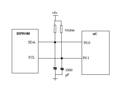

Below is part of my program,the oscillator for my controller is 24MHz.n the clocking for EEPROM is 1kHz.This program just simply transmit a 8-bit device select code for write operation...i donno y it jus cant works...I had connected the SDA n SCL to an open-drain I/O n tied to pull-up resistors.
