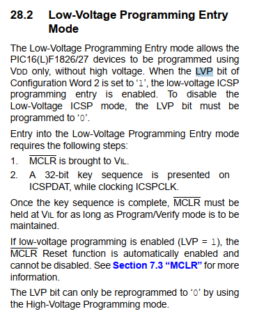

I'm curious... why would having LVP ON require a warning?
I can't remember but it was something along the lines of debugging was not available with LVP enabled - actually, think that was MCLR disabled.
If you search for "LVP" in the datasheet you will see it has a number affects on the device.
Programming mode, reset.....to name a couple.
Part of the info -
Regards, Dana.
I know what LVP does. My question was more to why would you want/need the IDE to issue a warning if it's enabled, like the last few posts were complaining about.
At the very least its a warning you are in ICSP programming mode on the chip.....
Regards, Dana.
Enabling LVP doesn't put you in any programming mode.
LVP simply means you don't require a HV (> VDD) on the MCLR signal to enable programming.
Presumably it gives a warning because the VAST majority of people won't want it ON, presumably it's only ON by default because you wouldn't be able to reprogram the chip otherwise if you only had an LV programmer.
I've probably never seen the warning because I turn it OFF automatically :D
Thanks for correcting my error. Seems like it enables entry into programming, not puts you into it.
I should read my own posted ref material in the future :).
