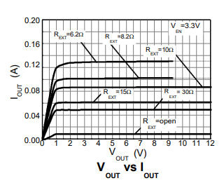

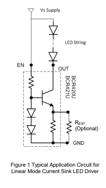

Interesting part series -
Package a little challenging....
Certain parts preconfigured for 50 mA. So one part solution possibly.
System would still need one boost converter if doing strings to supply
constant current source(s). Then one of these per string.
Regards, Dana.
