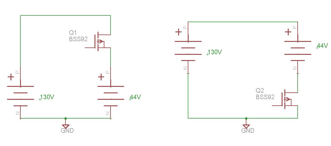

A conventional buck probably won't get you that efficiency with duty cycle required for 135v input to 44v output. You would have to do a transformer conversion like a push-pull smps to get the conduction percentage up on the MOSFET's to get the efficiency up. You use the transformer to do this.
You could probably do 92-93% with a conventional buck switcher. Even if you get low Rs MOSFET and real good coil the low Rs MOSFET's come with greater gate driving capacitance so you will eat into efficiency due to gate drive power.
Ground is relative. There is no law that says the negative lead of the solar cell has to be at ground. The positive lead could be at ground. The positive lead could be at +44V.
The buck supply on the left, the gate is hard to drive.
The buck on the right, the gate is easy to drive.
(many parts are missing to make the picture simple)
Yes it can, if the conduction losses are made low enough.
That is just a matter of making both the inductor and the switching devices large enough.
There is no minimum limitation on ohmic resistance, if you just keep adding copper and silicon to the problem.
Gate drive power and inductor core ac losses are both frequency dependant, these too can be kept minimal by using a low switching frequency.
It is not that difficult, it just requires larger components and more dollars.
But possible it certainly is............
