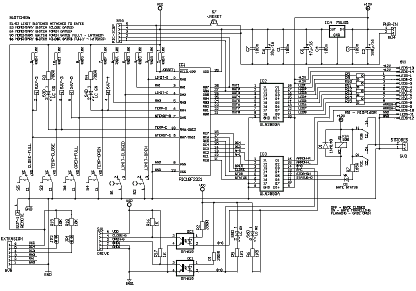

i need a simplified control circuit for an electric gate.which will open when the open button is pressed and also close whn the close button is pressed.The gate control cicuit diagram shoul contain limit switches to stop the gate in both directions when openning and clossing.Spring loaded switches should be used as well.

gates can behave pretty nasty when closing into a vehicle lacking safety circuits to stop the drive immediately and reverse direction if an obstacle is recognized.
Also it doesn't make much sense to fully open a gate if just a bicycle is being pushed through it.
Here is a gate control circuit using a PIC18F2321. Local operation is done using four push buttons for partial/full closing and opening. An LED indicates gate status (closed, moving, open).
The circuit offers connection of a wireless remote controller and via the extension port connection for obstacle recognition.
A strobe light indicates gate movement calling for attention.
The power circuit (DC motors 24V/300W) is isolated for the safety of the control circuit.
Boncuk
