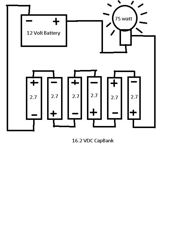

i drew up a precharge circuit that i think can precharge the capacitors safely, see attached.
Don't capacitors in series lead to a lower capacitance than any one capacitor in that series? In other words, putting them in series will give far less than the 156,000F expected by multiplying 56 x 3000.

correct. the capacitance is the same for all these caps. 6 in series is
1/C = 1/C1 + 1/C2 + 1/C3 + 1/C4 + 1/C5 + 1/C6
voltage is added together. each cap is 2.7 volts so 6 * 2.7

PS : if we model the 75W bulb with a 6 ohm resistor (rough estimation since its nonlinear), the RC time constant will be close to 1 hour...

ill charge up the caps with the lightbulb, whats the worst that can happen? the lightbulb explode? LOL
I don't think the light bulb will have any troubles but the resulting low input current could give you a tremendously long charge time!
If it was me and I wanted to charge them quickly without over current concerns I would be dumping them through a high wattage low resistance device like several space heater elements. 2 ohms at 144 volts would give you a peak current of 72 amps which is not much as far as a big deep cycle battery is concerned with.
Given a 1500 watt space heater is roughly 9.6 ohms four of them would give you 2.4 ohms and a peak current of 60 amps that rapidly tapers off as the capacitor voltage rises.
In regards to capacitor over voltage protection that has to be done on every single one. Over current is not an issue really. Over voltage due to imbalances in the true capacity of each individual one is the problem.
They may all be rated a 3000 F but the actual variance between the highest and lowest of the group could be that one is 2900 F and one or more is 3100 F. the higher capacity ones in the series will get less voltage built up across them but the lowest one will be getting over charged to the point of destruction.

I am not worried about the length of time to recharge the caps now... as long as its done safe with no explosions LOL
^ OK, if you're not worried about the time to recharge the capacitors, then what's the point of even having them? You need to be able to dump a lot of energy into them in a short period of time if you want to recover energy from braking. Otherwise, they aren't providing any benefits.

that was only for this one time precharge. not for full time use. I am just learning so start out slow and go up from there. Ill look at faster charging when I get the caps installed into a full pack, all 52 or them.. Ill be buying more this month. Id like to get it close to 200 volts.
ok, the lightbulb handled the current no problem and you were right, took almost an hour to precharge one volt!
I moved to using a 12 volt turn signal lightbulb from the truck itself. it charges faster and the bulb is lit up but not really bright so it handles the current with ease.
Ive read that the 75 watt lightbulb is a 6 ohm resister, the lightbulb maybe a 4 ohm. Ill need a lower ohm resistor to charge faster...

don't you even know the electrical basics of ohms law?
At 120 volts a 75 watt light would need to be, 75 watts / 120 volts = .625 amps.
To get .625 amps current flow at 120 volts you need a resistance of 120 / .625 = 192 ohms.
If it was a 75 watt 12 volt light it would be, 75 / 12 = 6.25 amps.
To get 6.25 amps current flow at 12 volts you need a resistance of 12 / 6.25 = 1.92 ohms.
What is the purpose of pre-charging those supercaps btw ? If you want to use regen braking, you need to have enough storage left in the caps to absorb the braking energy...
just precharging to see how they act and such. this configuration with 6 for 16.2 volts is to see how they act in place of the car starter battery. looking to so how many cranks they have in them.
