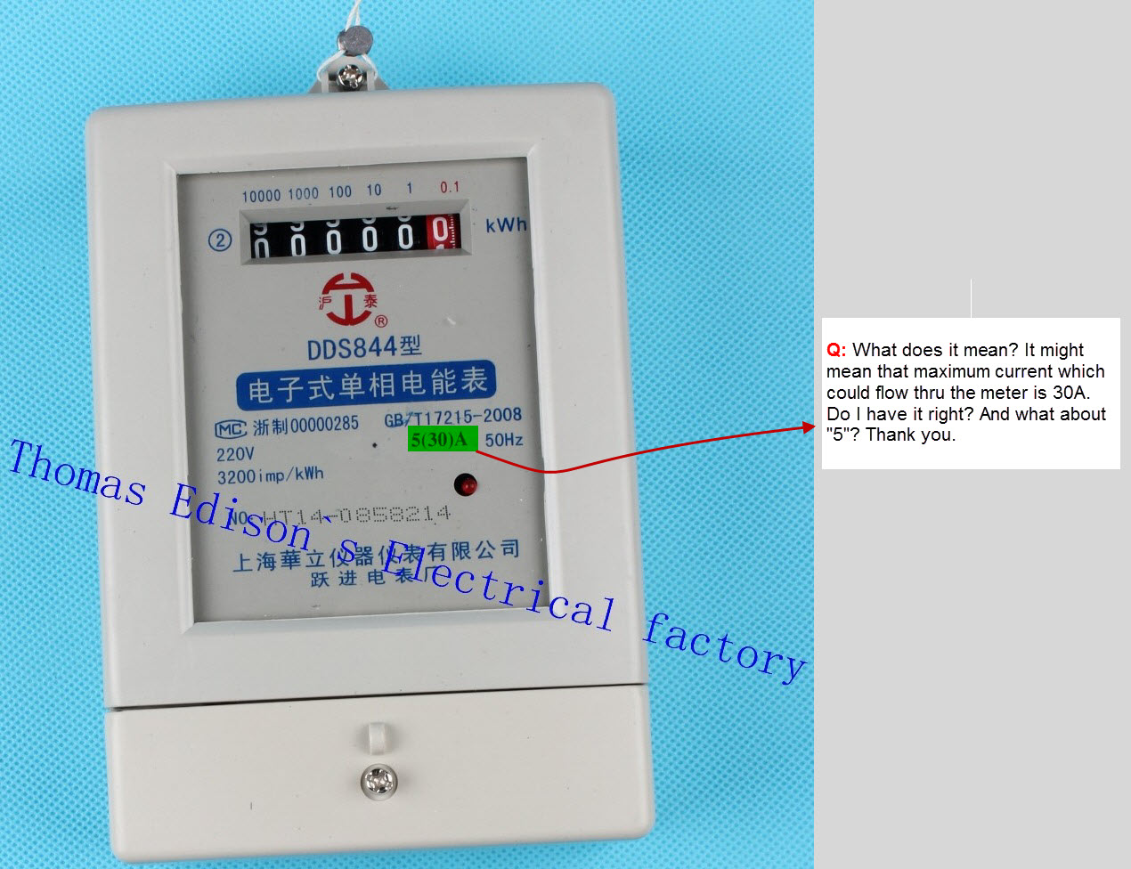

Please have a look here.
What does it mean? It might mean that the maximum current which could flow thru meter is 30A. Do I have it right? And what about "5"? Thank you.

With it being chinese I couldnt be certain, however that would normally mean 5a inductive load and 30a resistive load.
'Standards' vary so it could mean something totally diffrent.

The first number appears to be the "Test Amp Rating", effectively the current at which it is calibrated.
The second number is the maximum load current, which is generally 666.66% of the Test Amp Rating.

It could also mean 5A continues 30A max, a sensible spec.

It could also mean fake specs to be meet customer requirements. The original part is only 5(20) indicating a ratio of 400% which declines with higher current units.

It is supposed to mean 5A continuous and no loss in accuracy at (peak currents )

We have a single phase meter and it has written "10(40)A" on it. It can easily run two 2 ton air conditioners which approximately consume 4 kW which gives us the current of 18A (current=4000/220).
The labeling "X(Y)" is quite common on electricity meters. To confirm this you can have a look on some of the pictures from Google.
So far, in my humble opinion, JimB's explanation sounds more feasible.

The 5 Amps is the base load or the test current of the meter.
The 30 Amps is the maximum current for which the meter will measure accurately within its class specifications.
The thermal maximum load may be even another 20 % higher, depending upon the cable size and ability to dissipate heat from the meter terminals, the meter will be under reading as the current coil will saturate at excessive currents.
