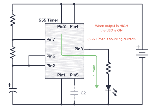

Classic 555 timer circuits :

As above, nothing gets things started with immediate feedback like blinky lights. Start with the 2-transistor classic, because the transistors are operating in their most simple mode, a saturated (on-off) switch. Next, a 555. Next, a 555 plus one transistor to have the LED fade up and down.
Back to the 2- transistor flipflop, attenuate the output into some powered PC speakers and scale the components for midrange audio. As you vary the timing resistor values, the character of the sound will change with the duty cycle. Next, same thing with a 555. There is an astable circuit variant with 2 diodes and one pot that lets you change the duty cycle while holding a constant frequency. Very 1980's synth.

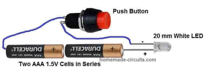

I would start by giving them a D cell battery and a small electric motor - make sure they understand what a circuit is
Then the same with an LED and a 3v coin cell. See if they can get it to light. The internal resistance of the coin cell prevents too much current from damaging the LED
Then have them put on some safety glasses and give them two D cell or AA batteries and an LED (or you can demonstrate it). The LED will flash and go out, it may emit some magic smoke or even crack the outer lens). But have them lear that some components are sensitive. This experiment will kill the LED!
Then give them a 100ohm resistor to put in series with the two 1.5v batteries (D or AA). Have them look into the LED installed one direction, then the other (diodes only work in one direction).
Have them add a switch in series.
Have them design a circuit for 2 or 3 LEDs (let them figure out parallel). Have them work in teams to use additional batteries to make 2 or 3 light in series.
