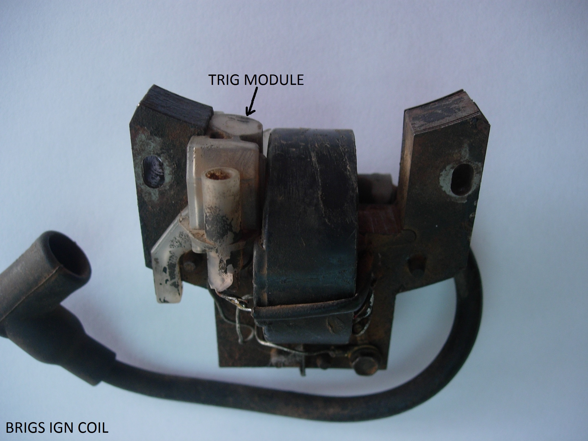

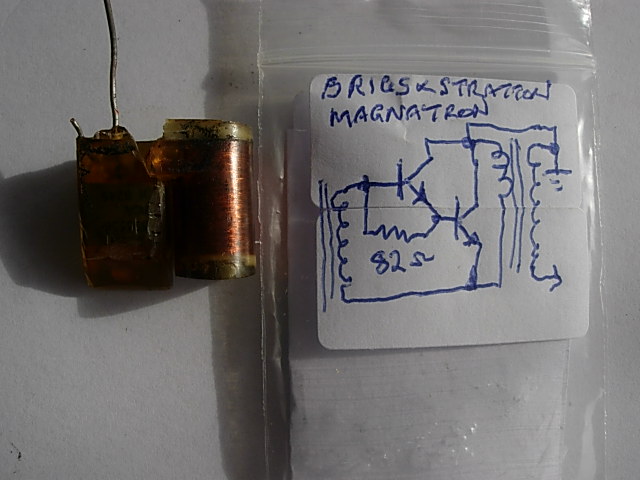

Anybody out there wondered what goes on inside the electronic magneto modules fitted to millions of small engines world wide. I have found that information on the internal circuitry and functioning of these units is either wrong, sketchy or non existent. Usual reply if the engine does not start due to no spark coming
from this unit is, "go buy another one, they are cheap enough". They appear to be the cause of lots of garden equipment ending up in the dumpster. I have tried to examine the internals of these units but de-potting the modules proves difficult. They all seem to rely on a Darlington switching transistor triggered by a tertiary winding on the coil assembly. One Chinese unit that was purchased recently, I managed to partially disassemble, had an obsolete transistor manufactured by a US company that went out of production in the 1990's. I reviewed the thread that featured the modification or replacement of contact breaker ignition circuits with an Atom Module? That unit is a replacement for the mechanical switch part of the ignition circuit and takes the output from the primary winding on the magneto.
Any thoughts on these units, circuit description or details would be appreciated.

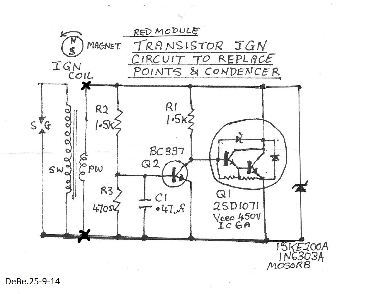

This is the circuit of the Atom Ignition module, used to replace points & condencer. This basic circuit is used internaly in small engine ignition coils. Very hard to dis assemble, but depending on how it failed you may be successful in fiting this circuit external to the coil conected to the kill wire on the coil.

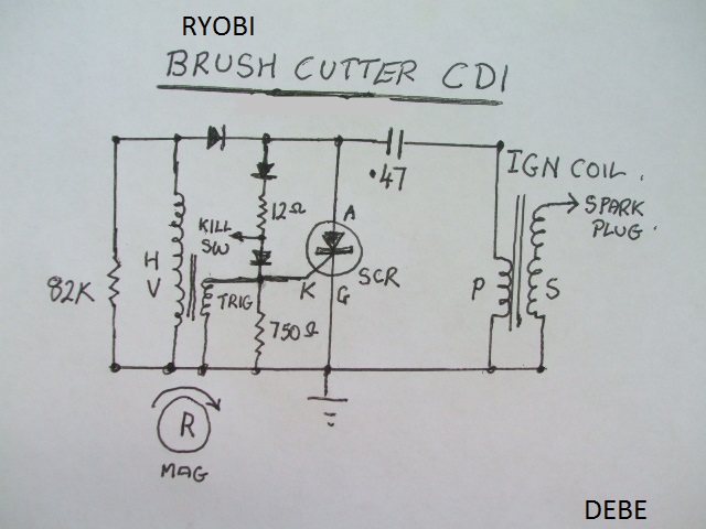

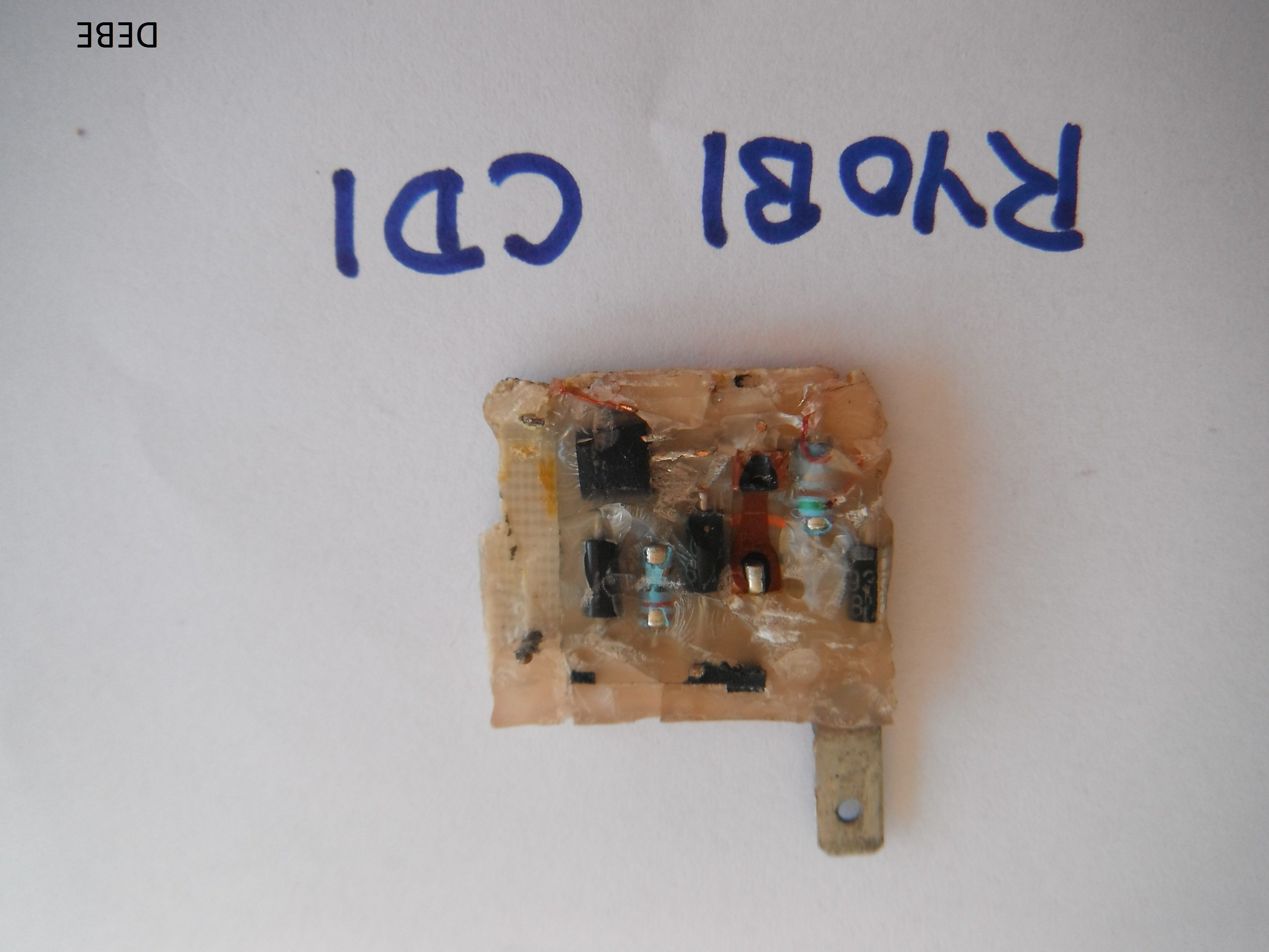

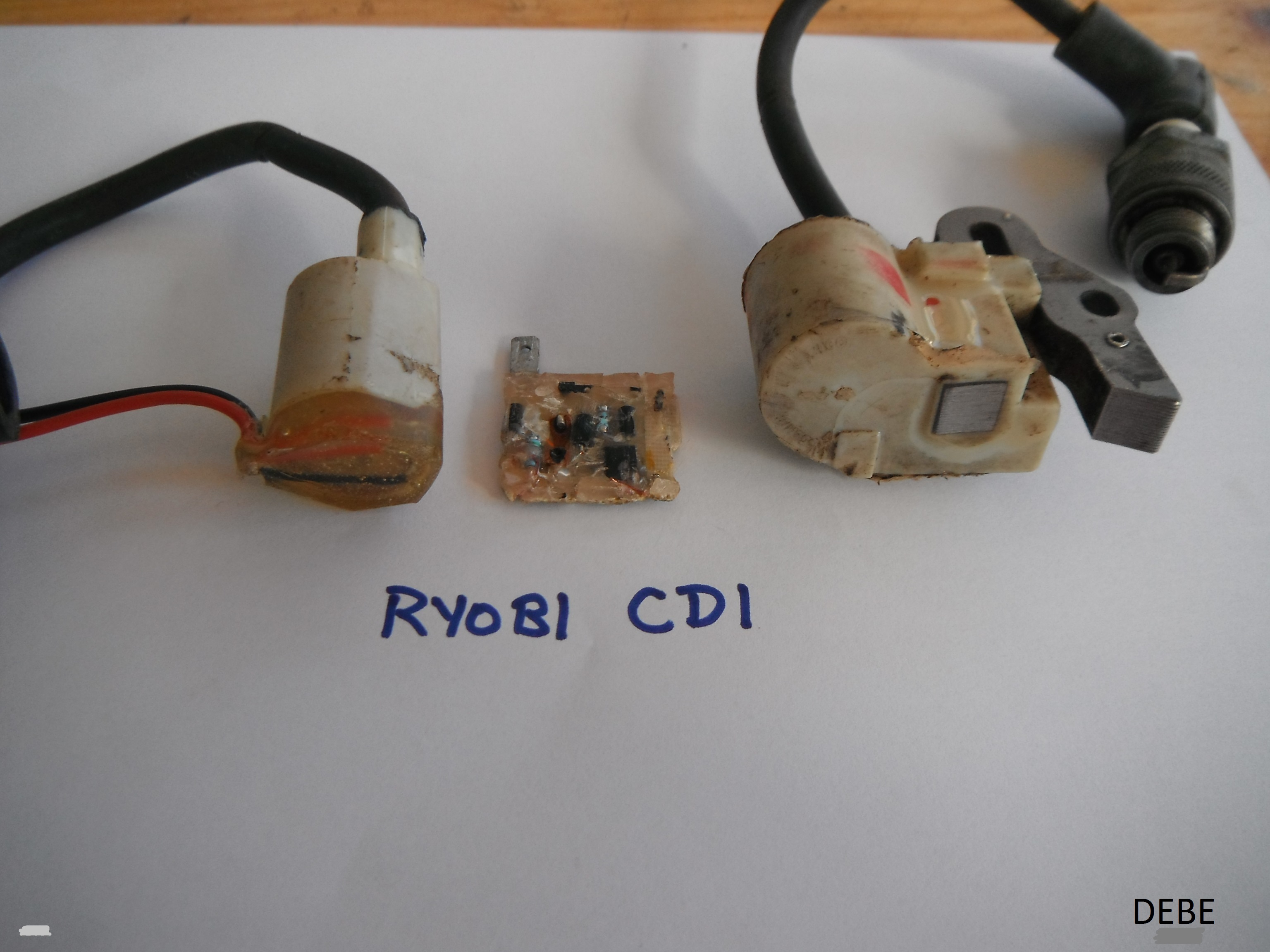

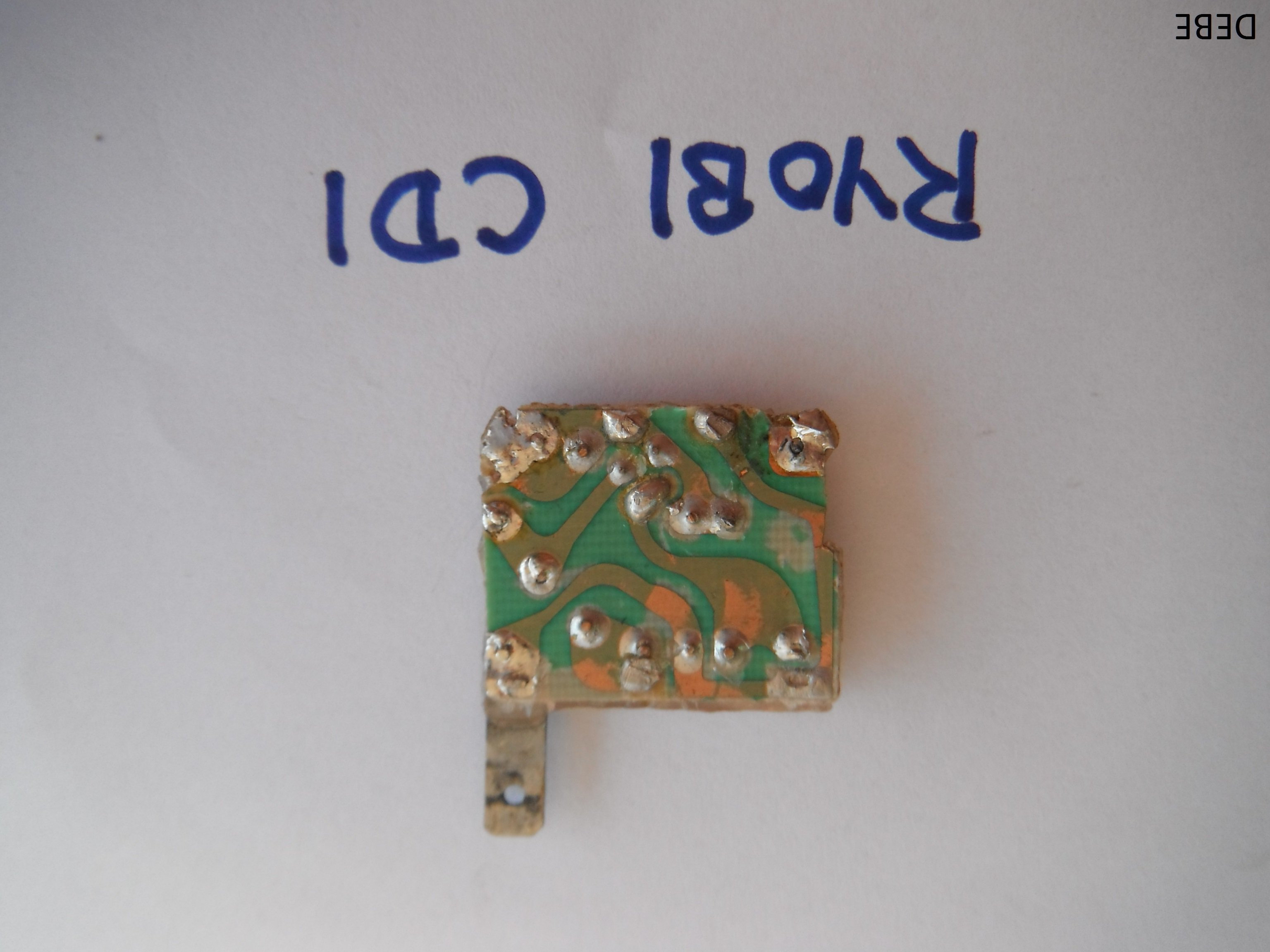

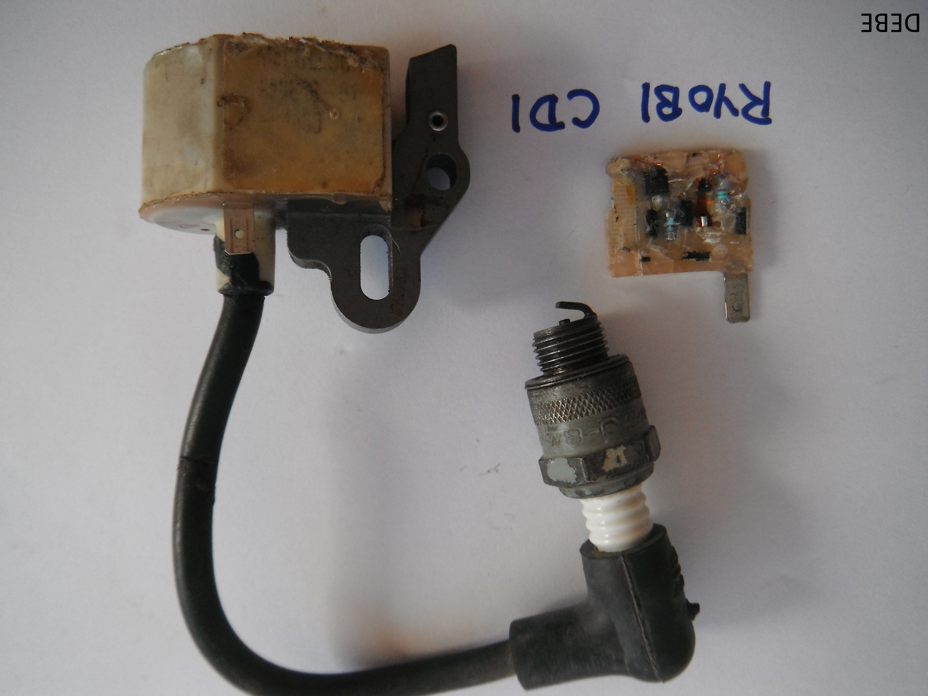

This one is of a Ryobi Brush cutter & its a CDI unit built into the coil assembly. Not all that common.

I'll give it go. The Darlington pair has 2 base-emitter junctions in series so base voltage needs to be about 1.5v to start collector current flow and may be up around 2v to enable full load collector current. Collector voltage will higher than that. So when the magneto begins to generate voltage, R1 will drive the base and the transistor begins to turn on and primary current flows from the coil through the transistor. There will be about 2v across this arrangement. Meanwhile the small transistor with only 1 base emitter junction requires only about 0.6v to begin to turn on. The 1.5kohm resistor and 0.47uF capacitor causes a delay in base voltage rising to this voltage. BUT when it does, the transistor begins to turn on and shunts current away from the Darlington transistor base. This causes the Darlington to begin turning off and the voltage across it rises, giving more base drive to the small transistor and the process rapidly continues shutting off the primary current almost completely, and Voila, Spark
That delay caused by the resistor-capacitor (time constant) arrangement can be changed to select the appropriate ignition timing.
