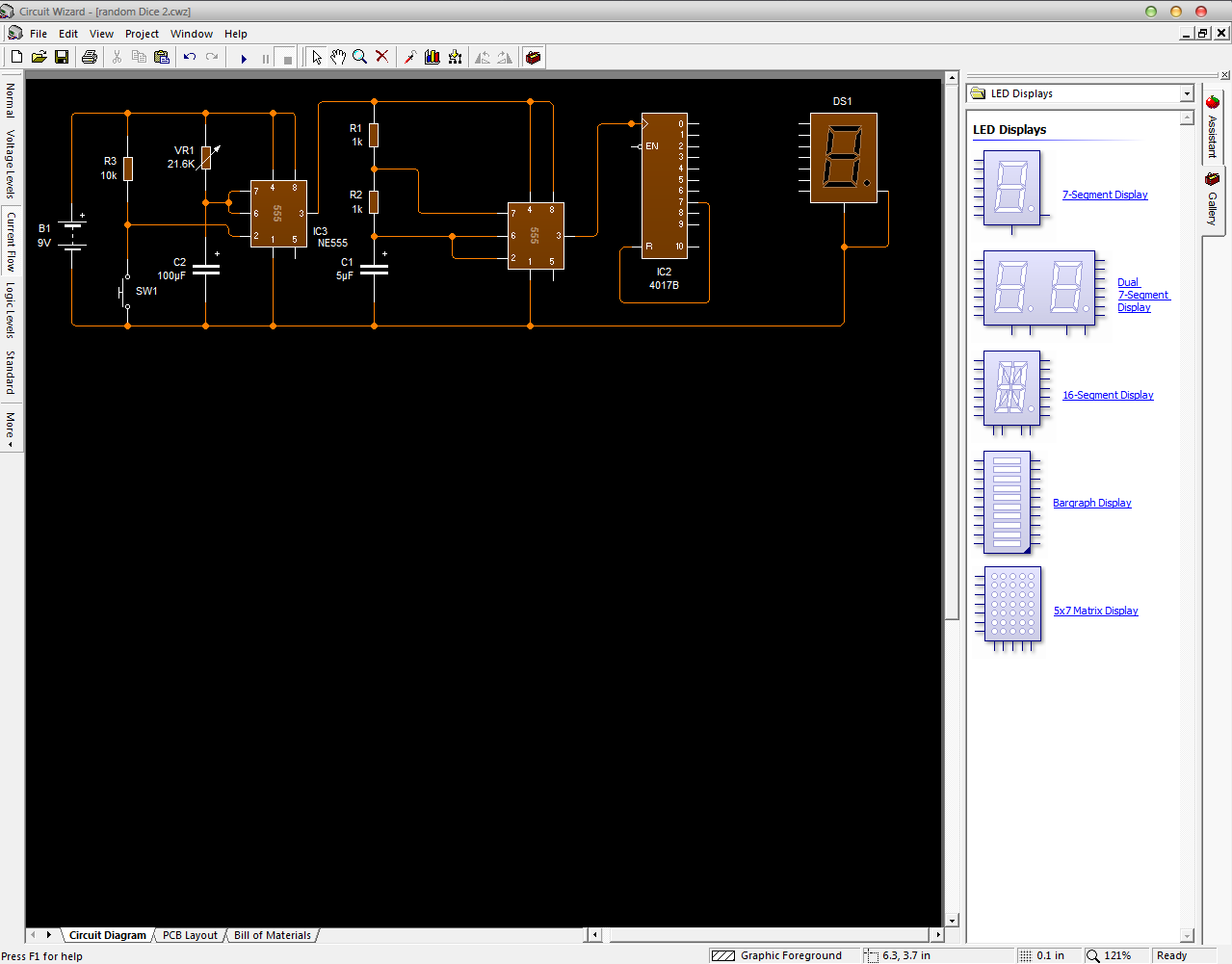

OK, my time is very short, so I need help quickly, what I need is a programmable chip, which sends out digital pules (on,off), so as to allow me to create a random die display, the reason I need to know is because if I simply try to connect the decoded decade to the display, wire run over each other and cancel each other out, where as if I had a programmable chip, when say, a current is put though pin 1, a current is put though the output of pin 2 and 3 to make a 1 on the display, so thats why.

Almost any suitably-programmed microcontroller could put out the necessary signals.
PIC microcontrollers, by Microchip, are very popular. The problem is that it takes a while to learn to program them. Not to mention, you'd probably need to buy it online, as well as a programmer, and shipping would usually take a week or two. Was this just assigned? If not, why did you wait so long to start?
Personally, I'd go with the 4026, which combines a decade counter with a 7-segment LED decoder. You have the clock input from the 555, and it connects directly to the 7-segment display. It automatically sets the right outputs high for each number. There are also separate chips to do this, but I couldn't find one at first glance. The 4026, though, is probably your best choice.

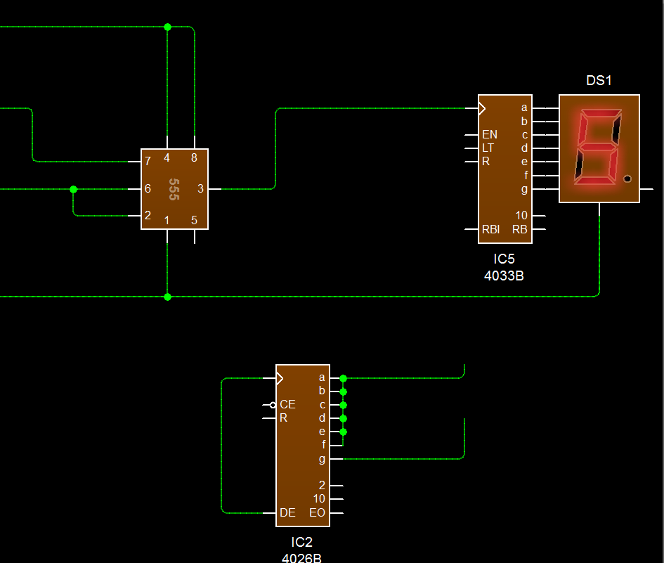

I took your advice on changing the chip and it works, although, I cant find the right chip to connect the reset pin to, to stop it from going over 6, have any ideas.

Why does IC2 have the outputs a to f shorted together? The chip won't like that.
I see, so you went ahead and used the combination counter and decoder in a single chip? I think you'd have to reset it manually, unless you tie in a regular decade counter to "hit" the reset pin of the combo when it reaches 7. Does that make any sense? Basically, as the chip is counting up the combo, and the numbers are showing up on the display, it is also triggering a regular decade counter to count up as well. Then have output 7 connect to both the reset pin on the combo and also the reset on the decade. That's the only way I can think of right away to make it work, unless you still want to use a microcontroller. If you want to learn to program a chip, it won't take much to get it to work (once you know how). It's completely up to you.

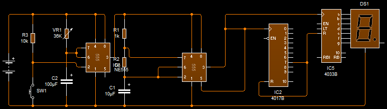

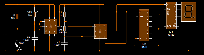

Just to say I have got it working, I got an idea from when you said you could make it rest manually or use a programmable chip, so what I did was: I got a normal 4017b (decoded decade) and attached the power pin to the 555 pin 5 and the output pin 3, (which the 4033b chip is connected to), then I connected the reset pin of 4033b to pin 7 of 4017, so affectedly, making chip 4033 rest from 0 every time chip 4017's pin 7 had voltage, which was when the display showed 6, it would rest back to 1 and start over again, So thank you for the inspiration derstorm8!
Is it working then? I'm trying to understand why you connected the power pin of the 4017 to the control pin of the 555. I figured you could simply connect the clock pin of the 4017 to pin 3 of the 555 (through diodes, because pin 3 is also connected to the clock of the 4033) and output 7 of the 4017 to the reset of the 4033. Could you post a schematic of the setup you have now?
Oh, you don't have to have pin 5 connected to the clock of 4017, Iv'e undone that know and it still works, it must have just been a paper weight wire.
Now if you think about it, I could run into a huge problem of, when you run it and start the timer the out come will always be 3, when you turn it off and back on, there is no way around this, unless I allow the user to play around with the time, using the variable resistor, unless there is a way to randomize the time?
