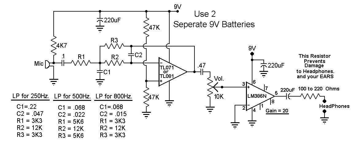

Thank you John for the schematic.
1) why did you need 20k pot before lm386 instead 10k?
2) can I just use a resistor value by calculating the clipping point for lm386 instead of pot to output one sound level all the time?(just trying to eliminate pot in prototype)
I changed the pot to 20k so that the capacitor coupling to it would not need a huge value.
The pot is a two-resistors voltage divider. Adjust the pot to what levels you want then measure its two resistances and use two fixed resistors to replace the pot. Do the same with the gain adjustment if you want.

hello gary, I tried your circuit, for 800hz. but for some reason its attenuating low frequencies like 100hz or below as well. its kinda acting bandpass. please look at following scope output attachments of raw signal. and lowpass output for 80hz and 400hz
do you have any clue?

Yes, Gary's circuit had its coupling capacitor values too low so it cut low frequencies. I simulated it and fixed it but it does not make as much as a second-order (12dB per octave) lowpass filter.

Changing the 33k of R5 and R6 to 43k makes the -3dB cutoff frequency 80Hz, not 800Hz. Changing C3 to 4.7nF makes the filter a single order with a cutoff at 52Hz then C3 increases the slope to second order above at above 1700Hz.

sorry i meant both c3 and c1 should be 4.7nf for 2nd order 800hz... I figured it out but just double checking because, you made a typo here
