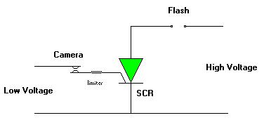

it sounds like an SCR might be suitable,
but i would like to hear more about the trigger mechanism.
As olly says, it usually worked an electrode to set off the
main discharge, the main discharge did not normally go
through the camera contacts.
John :)
I don't know the arrangement that you are using,
but i am pretty sure that it does not include a
four hundred volt battery, this would be stepped
up from a lower voltage.
So there should be a lower voltage available in
there somewhere.
Use the lower voltage to operate the SCR gate.
Check the wiring, as it is quite likely that one
side of the flash has to be connected to common,
if so then come back and describe the wiring,
so as a suitable layout can be presented from someone.
This diagram is only to show that using an SCR is a
possibility, the layout shown may not be suitable.
Please give as many details of your setup as you can.
Regards, John :)

Hi Tony,
I had a look through your post,
and i think this is the page that you refer to:
http://www.carlmcmillan.com/images/Optoisolated_Adapter.GIF
i wasn't able to be sure of the other page, 'Sam's Strobe'
i couldn't find it for certain.
Anyway,
just in case you aren't sure about opto-coupling,
here it is used to operate the triac without touching it.
There is a small gap between the little light and the
light sensitive triac, so the signal is isolated from the
triac. This is called an 'opto-triac'
Because the contacts on the camera are isolated from the
flash unit, this is why a separate battery is required.
This separate battery only has to supply the triggering
signal and can be quite a small battery as its normally only
an LED that has to light to operate the opto-triac.
Mr Zimmerman recommends that the triac is driven hard to
minimise response times, so i suppose you should make sure
that the led in the opto-triac does not appear dim, the
series resistor controls the current through the LED, but
don't make it more than the manufacturers rating. The life of
an LED can be very much reduced if they are made to pass even
a little more than their rating.
Personally i would not have thought that it would make any
difference to the triac so long as it worked. But i would be
guided by Mr Zimmerman as he seems to think it does.
You can check the ratings and figures on line by looking up
the opto-triac details of the one you have.
When going to get the part, ask at the shop for an opto-triac
that will handle the voltage and current you need, rather than
looking one up, then trying to get it at the shop.
On that page there is also a schematic gif:
This shows on the left side,
the camera contacts and the resistor which limits the current
to the LED.
I don't know why he has used an opto-triac to drive an SCR.
Maybe he couldn't get an opto-triac rated for the job,
or maybe the smaller ones are quite cheap.
Anyway the circuit looks perfectly ok to me.
