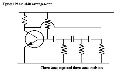

So i opted for a phase shift oscillator, i know them to be
fairly simple, but until then i had never built one. I looked
at all the designs i could find on the internet, and they all
were arranged like this:
After i had tried making the resistors very high values, many
megs actually, and making the capacitors as high as i had, that
could be used in that circuit, i soon decided that to get higher
values of capacitance i would have to use condensers, or
electrolytic capacitors as they are now known.

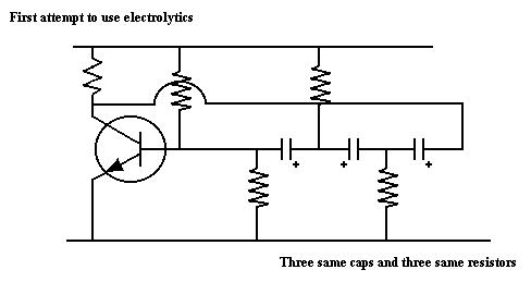

The problem here is that electrolytics are uni-directional,
unlike the ones in all the circuits i could find, which are A.C.
working.
So i tried staggering them, with one up, and one down, so as to
keep the uni directional voltage, and also pass the signal,
like this:

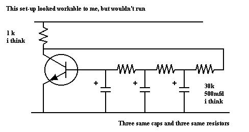

I didnt get that to work, so i tried putting the caps to ground,
and the resistors going from one to the next, like this:

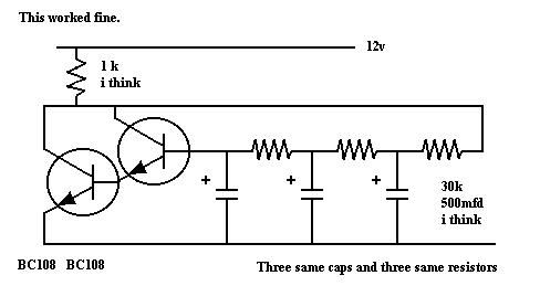

When that didn't work either, i was most perplexed. It took me until
the next day to realise why it wouldn't work. Quite simply, the
attenuation is so severe that it needs more gain. I stuck another
transistor in as a darlington pair and bingo, works a treat.
Like this:
Unfortunately i cant find the notes i made at the time of
construction, except a few scrawly bits without any values
written in.
But i think the caps were 100 mfd, just ordinary ones,
and i think the resistors were about 30 k-ohms.
you will have to mess around with the values to get the sort
of frequency you're looking for.
Best of luck with it, John :)
