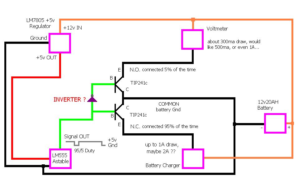

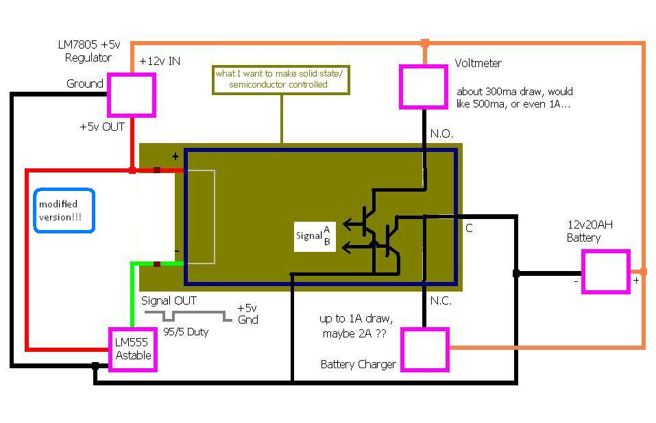

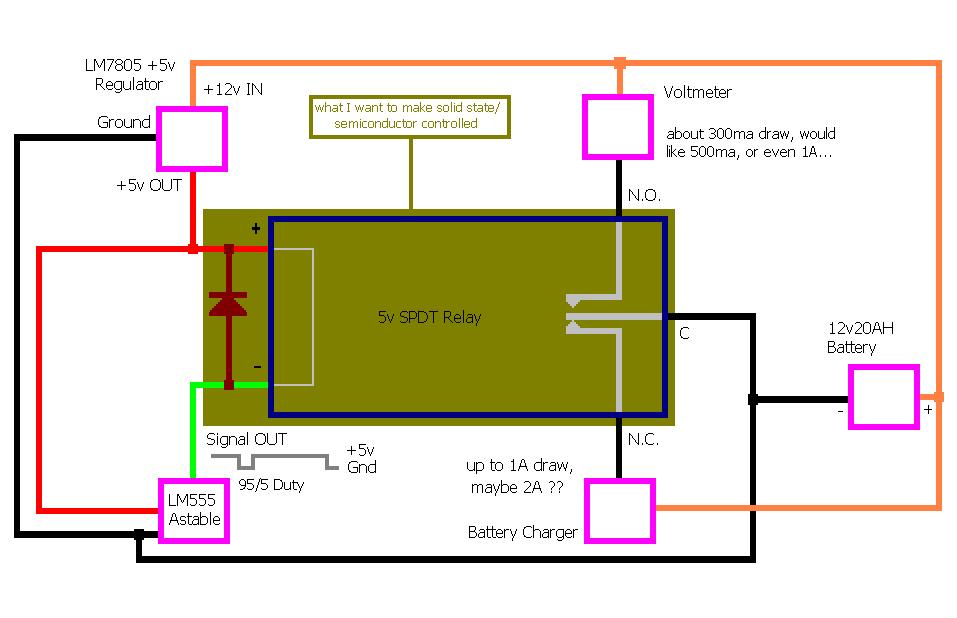

Eliminate a relay, make it semiconductors...
Is there some sort of a way to eliminate the area of this circuit that is
boxed by the lime green (the relay and if necessary the diode). I'm guessing
I need a couple transistors which will switch the negative signals, one that
gets triggered by a positive signal (and it's circuit will draw up to an amp,
but ideally I would like it to handle two amps), and the other triggered by a
negative signal (and it's circuit will draw up to about 300ma, but I would
like maybe 500ma, or even an amp just to make sure). Any ideas what
devices/transistors/circuitry I could do this with (see attachment for circuit).
You do realize, one is being switched with a positive 5v
and the other is being grounded...I'm sure this will work with
one but how is the other going to conduct (if they're the
same transistor, doesn't that mean they'll both come on
when the line in is +<pnp> or -<npn>) ??? It's only one
line in, at gnd or +5v. Will I need to invert the signal for
one of them (I'm using some 74ls86's in the circuit
anyways)?
I like the looks of the tip41c, lots of current.
Also, in your circuit, I am going to need to sever the
connection from the battery to the common, and use
only the charger to the tip41c on the right in the drawing. Correct?

I isolated the voltmeter and your charging system. The two transistors allow only the paths from Vcc-(Charger or Voltmeter)-GND when it is switched on. Just imagine those transistors as a simple open switch, with the current from base to GND will turn 'em on.

BUT...I think the inverter needs to be for the other transistor !

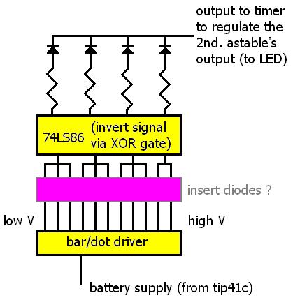

I mean, if I tie the outputs of the bar/dot driver, should I use diodes (this
is after the transistors). I would like to make an XOR w/ a few GP transistors, in
order to conserve space as opposed to a whole dip (I am using one 74LS86 which
has 4 of them, for different oscillation levels of the single LED, having the bar/dot
select the resisitor for that LED's astable frequency, and would like to keep the 4
levels of flash rate, but then I would need a whole 'nother 74LS86 and only be
using one gate in it <to invert one of the tips>).

I would like to make an XOR w/ a few GP transistors, in order to conserve space as opposed to a whole dip (I am using one 74LS86 which has 4 of them, for different oscillation levels of the single LED, having the bar/dot select the resisitor for that LED's astable frequency, and would like to keep the 4 levels of flash rate, but then I would need a whole 'nother 74LS86 and only be using one gate in it <to invert one of the tips>).
Yes, I understand what you want to do. But building your own gates is not space-saving AT ALL. There are TTL (transistor-transistor logic) schematics, but it is just to guide you to understand how gates work. These circuits are fabricated optimally, while building these gates from scratch is not wise. You'd be better off with the DIPs.

The voltmeter circuit is a bar/dot driver, outputting a negative signal (but I need a positive), so the 74LS86 is inverting the signal, connecting different resistors to the 2nd. astable, so the single LED from it flashes at a different rate depending on how high up the bar/dot driver (in dot mode) is (according to battery voltage). The resistors get a diode before the timer, but I want to tie multiple outputs to the same resistors (instead of 10 sets of resistors and diodes).
Why are you using 74LS86 to invert signals? Here's an inverter IC for you:
https://www.electro-tech-online.com/custompdfs/2009/12/sn74ls04rev5.pdf
As for the resistors, I'd put in each input. It may be tedious, but it stabilizes your circuit.
Do you mean, the diodes? Between the bar/dot driver and my tying the outputs together?
oh.. diodes? I see not much harm if you ignore the diodes.. but if your IC have reverse current effects you might need to include them. You can try first. If there is no problem, carry on without diodes. I doubt it can damage your IC if you don't have the diodes.
