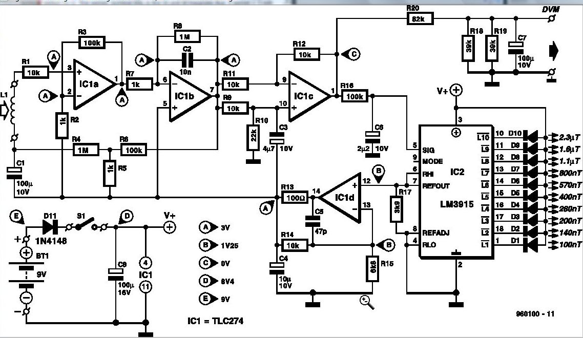

I need help finding an EMF detector circuit with LED bar graph output. I'm into the ghost hunting world and think it would be great to build my own detector instead of buying a KII meter. I have built other devices for ghost hunting but can't seem to find a circuit on the EMF detector. Thank you for any info or input on this matter.
What does an EMF detector detect? Is it just a very high-input impedance voltmeter?
How about this one? It only took a moment of googling to find.

The circuit will pickup mains hum and every radio station, TV station and taxi cab radio in town.

There are hundreds of EMF detector circuits in Google but they detect AC and radio signals, not ghost imaginations.

There are many emf meter schematics on the web that can be found by googling. Most require use of a voltmeter instead of an LED bar graph. It is a simple task to add an LED bar graph to the output of any of those schematics by using the data sheet example circuit for the LM3915 or one of the many other bar graph LED driver ICs that are available.
