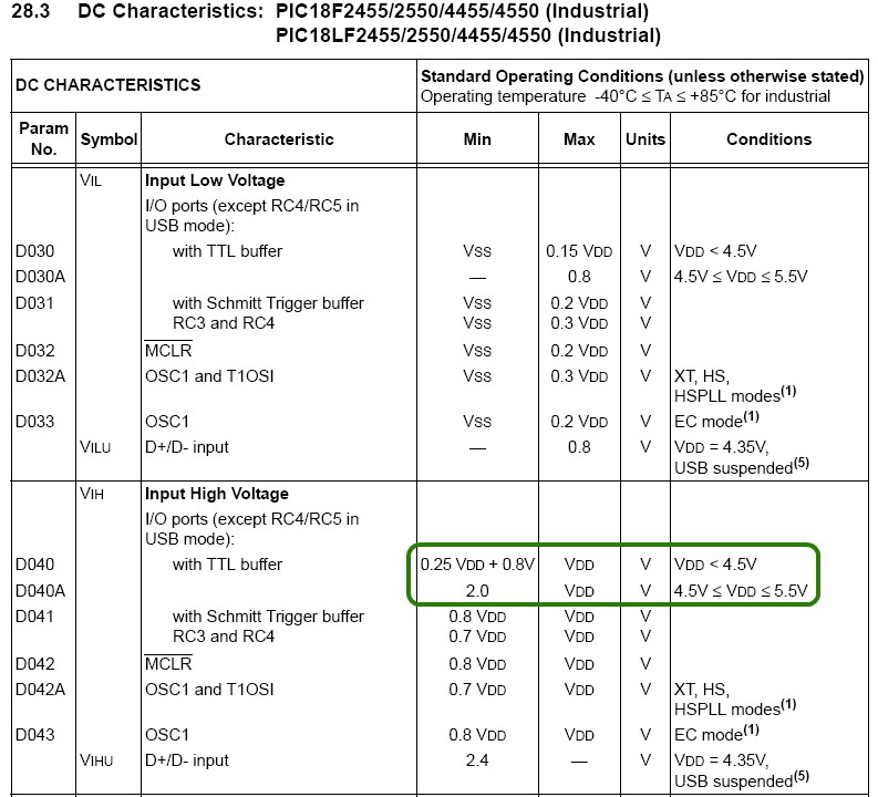

It will not work directly, because on PIC high level starts from 0.7 Vdd and up.

Don't mind the attached picture.

Pictures are great, I love em. I read that picture differently, the 0.8 VDD +.25 is for less than 4.5V the 5V spec says 2.0 volts min. Maybe I'm reading it wrong...

I'm guessing that level transition was (and still is) needed for 16 series as these operate on 0.7Vdd (3.5V). The 18 series appear to have been designed to work with 3V logic.

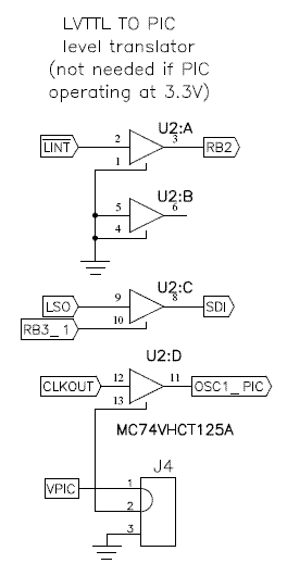

Papabravo hit the nail on the head according to Microchip;
The ENC28J60 is a 3.3V part; however, it was designed to be easily integrated into 5V systems. The SPI CS, SCK and SI inputs, as well as the RESET pin, are all 5V tolerant. On the other hand, if the host controller is operated at 5V, it quite likely will not be within specifications when its SPI and interrupt inputs are driven by the 3.3V CMOS outputs on the ENC28J60. A unidirectional level translator would be necessary.
An economical 74HCT08 (quad AND gate), 74ACT125 (quad 3-state buffer) or many other 5V CMOS chips with TTL level input buffers may be used to provide the necessary level shifting. The use of 3-state buffers permits easy integration into systems which share the SPI bus with other devices. Figure 2-5 and Figure 2-6 show example translation schemes.
Actually, the parameter D040 is with TTL buffer. The SDI pin does not have a TTL buffer, so that parameter is irrelevant for your application and parameter D041 (RC3 and RC4) applies.
