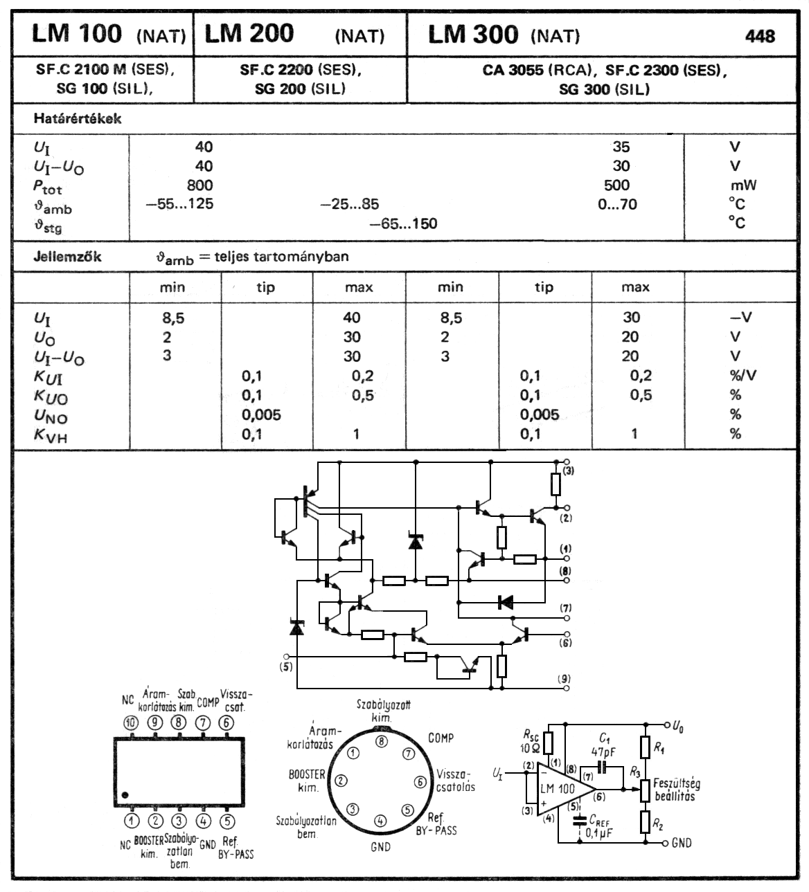

i want to know if there is an equivalent for the LM100 Ic
it is a voltage regulator Ic.thank you
Nothing special... If not available, You can use LM723C.

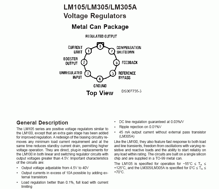

I think LM105 would be a good Substitute.
Here is the PDF Datasheet for LM105
  • lm105_lm305.pdf
