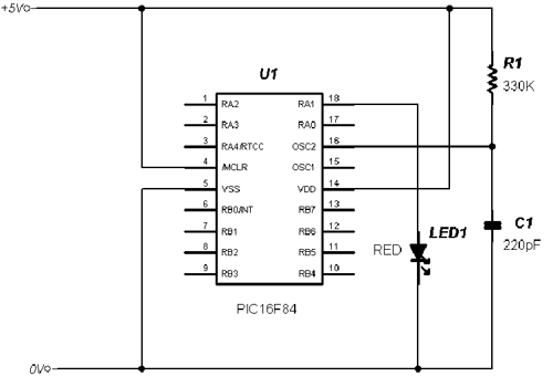

Isn't a resistor needed in this schematic?
Just cleaned it up a little.
