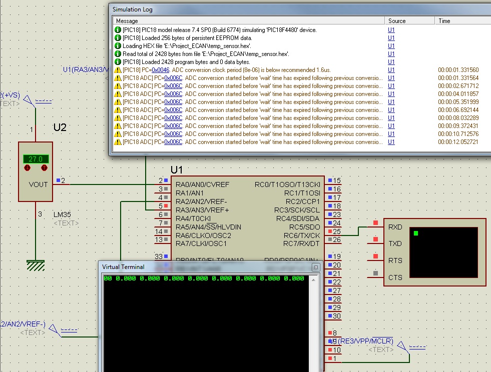

Hi, i do realize that its been a long time when you started this thread. However i am stuck in the same place.
I have attached the image of what i am getting in simulation with this. Is there a way to fix the warning. I have used your same code.
Can you please tell me the value for TRISA and AN0, AN1 and AN3 aswell.
Tip for all... when dealing with more than 1 ANx pin.. Set the pins as input ... when ever you are going to get the value of another pin turn off the ADC then set the ADCON pin then turn it back on. This will save headaches...
I am only getting values either 0.000 or 1.000 but nothing in between for extreme temperatures (on Proteus).
Here is the code i have modified (from yours):

while(1)
ADCON0bits.GO=1;
while(ADCON0bits.GO);
adctemp = ADRESH;
adctemp = adctemp<<8;
adcbits = adctemp|ADRESL;
adcvalue = adcbits;
adcvalue = ((adcbits*3.3)/(1023));
adcvalue = adcvalue * 1000; // Multiply by 1000 to include 3 d.p's
adcbits = adcvalue; // Force interger value xxxx.0000
adcbit0 = adcbits;
adcbit0 = adcbit0/1000; // Extract "thousands" value
adcbit1 = adcbits-(adcbit0*1000);
adcbit1 = adcbit1/100; // Extract "hundreds" value
adcbit2 = adcbits-((adcbit0*1000)+(adcbit1*100));
adcbit2 = adcbit2/10; // Extract "tens" value
adcbit3 = adcbits-((adcbit0*1000)+(adcbit1*100) + (adcbit2*10));
adcbit3 = adcbit3/1; // Extract "singles" value ***Good Practice***
SendData(adcbit0+48); // Output to UART in ASCII
SendData('.');
SendData(adcbit1+48);
SendData(adcbit2+48);
SendData(adcbit3+48);
SendData(32); // Space
Delay10KTCYx(60);
