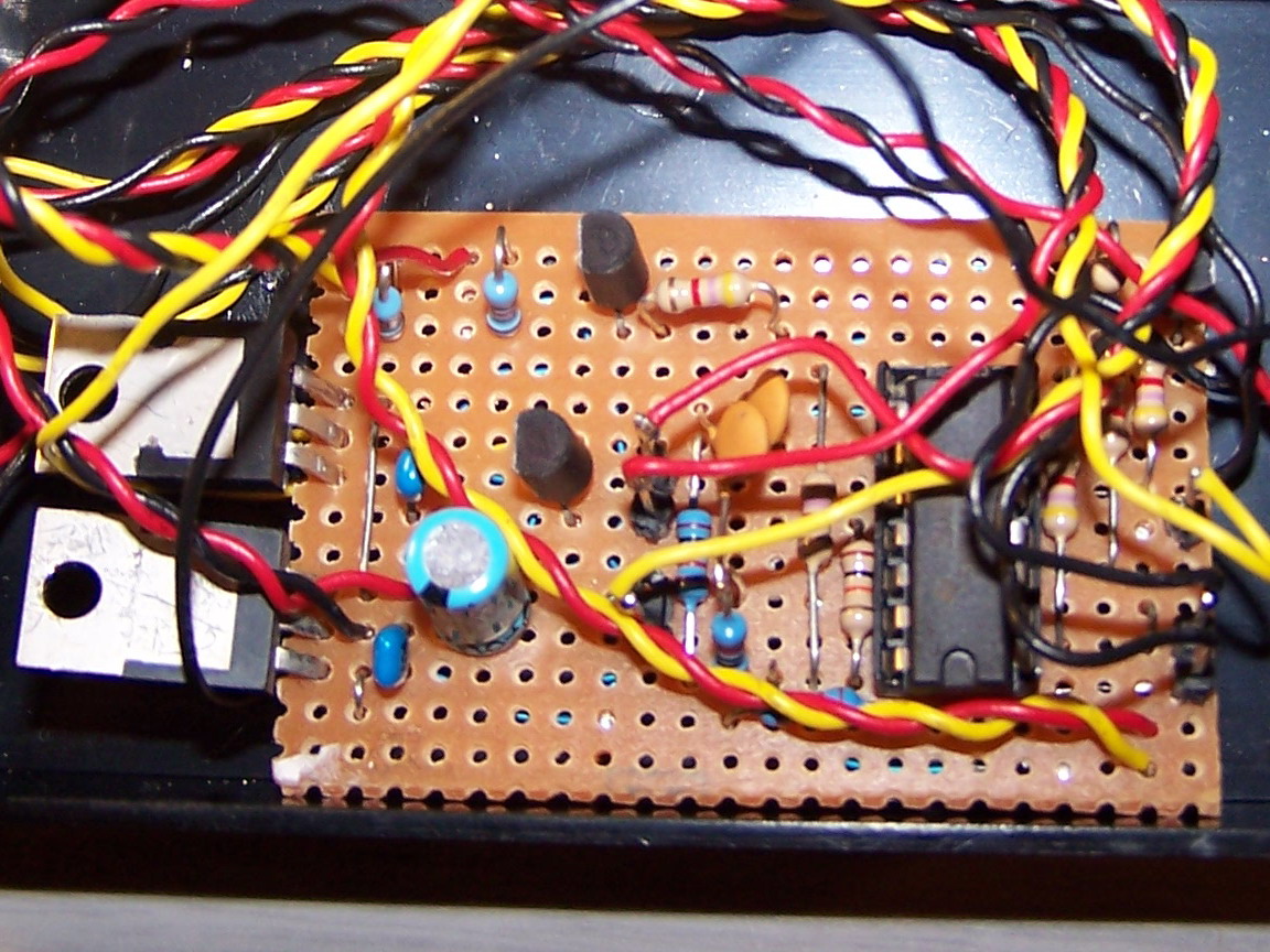

i've deleted all my printer drivers and tried setting my parallel port to normal, it was set to epp - no difference. I've attached a pic of my board. The wires are connected to a ic socket.

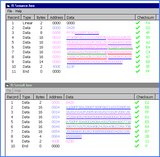

below is the hex after I program the pic and read it back - shouldn't it be the same :x
:020000000428D2
:10000400A100FF30A20007309F00211033200530EB
:10001400162023142F200530162023102F200C28FF
:100024001528A4002408A5006430A6000A301D2861
:10003400A700FF30A8002608AA002508A9007730E9
:10004400280703182528A90B2428AA0B2228A70B64
:1000540020280800302823088500080034282108B7
:04006400650008002B
:02400E00623D11
:00000001FF

You said you were using a shielded printer cable, yet all i see is a bunch of unshielded wires wich are curled together. It won't work like that...
how long are these wires ? i've had p16pro40's fail because of 15cm unshielded wires between progger and pic...

Hmmm, I think you got it Exo! That would explain the weird behaviour.
Those wires connecting the socket to the circuit look a bit long... They might pickup radio stations and write a mix of object code and "Stairway to heaven". I think I recognize a guitar riff encoded in that second hex file :P:lol::P
the shielded cable is between the computer and the programmer.
between the programmer and the pic I have the single cables. no longer than 10cm
Yes, try replacing them with shielded cables and untangle them, curling them up increases wire capacitance greatly...

Your programmer is fine. See the comparsion of the two files(I make them into two files from your previous posting) you have posted.
What you have read back from the PIC is actually what you have programmed, except with one error which happened while programming and caused offset in address.
Why the error happened I can't tell. Except that the "FF30" at address 0008 just disappeared into thin air and the rest of the code placed into address starting from 0004.
There appears to be a one-bit error difference in the last word but as it is the config word and that the difference location is bit9 which is not implemented in the config word so it is not an error.
