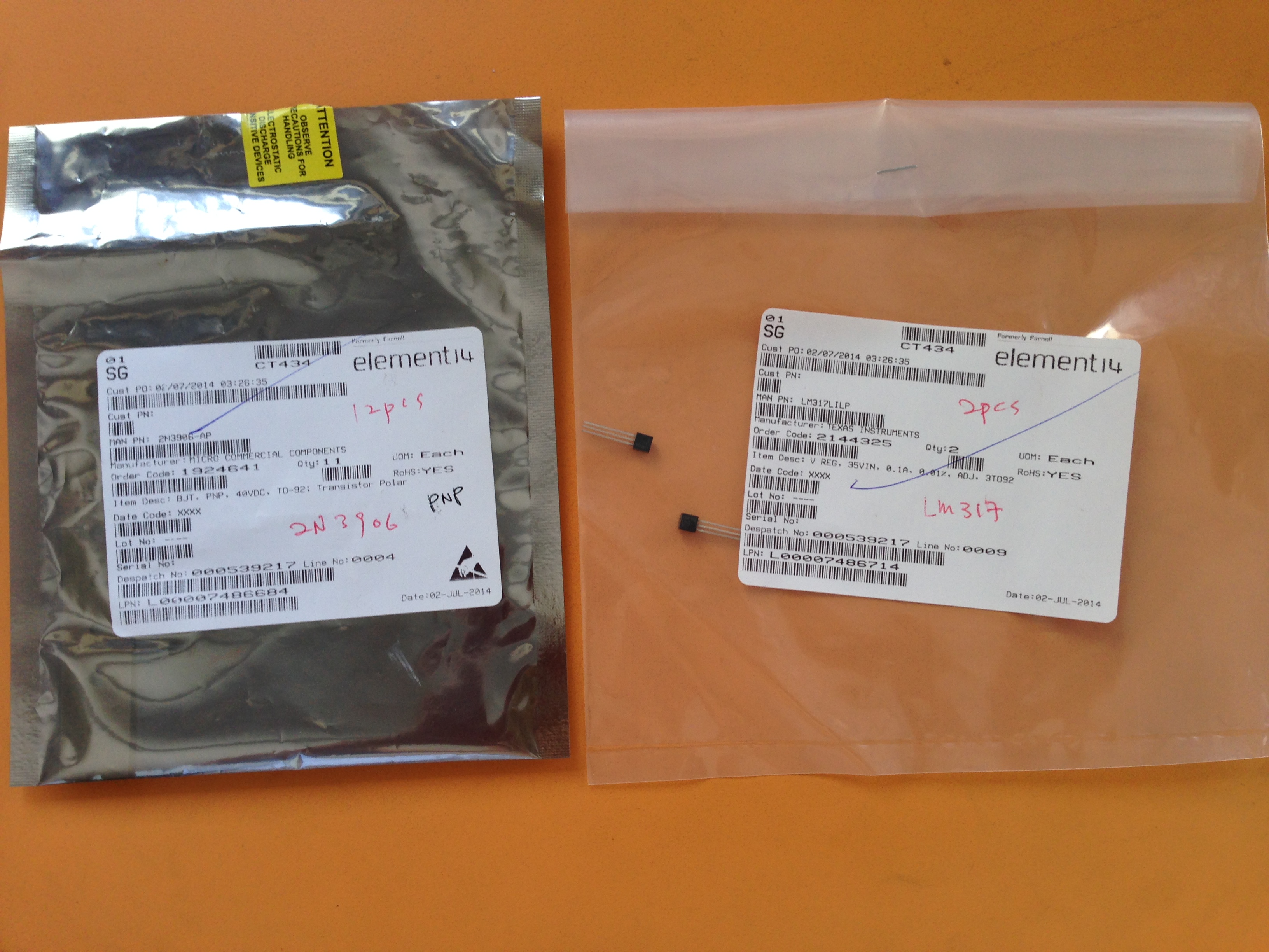

Dear all,
I bought some loose components from Element14 recently, and found that my LM317LILP (TO-92, 3-pin, order # 2144325) was delivered in a non-ESD bag, while another component 2N3906 (common PNP TO-92 transistor) was packed in ESD bag, see photo attached. To my surprise, Element14 replied that according to page 7 of the LM317 datasheet (https://www.ti.com/lit/ds/symlink/lm317l.pdf), ESD packaging is NOT required. However I did not find anything relevant in said datasheet (sure I am not good enough to understand all in the datasheet)....
Anyone knows about ESD packing requirement for delivery/shipment of (sensitive) electronic components, kindly comment....
You are correct, the datasheet in your link does not appear to make reference to ESD precautions.
I would have expected a semiconductor device from a major supplier to be supplied in an ESD bag as a matter of course.
The last lot of 3 terminal regulators which I bought from RS Components came in a ESD bags, as does EVERY semiconductor device which I by from them.
The latest reply from Element14 is as follows:
"It states NON APPLICABLE for MSL (Moisture Sensitivity Level). Only those product with MSL level 1 and above requires ESD packaging."
Fyi, the above message again refers to the page 7 of the TI LM317 datasheet....
But I know that MSL is relevant to PCB assembly process in the production floor, and should not be used as a guide to decide if the item needs be packed in ESD bag during shipment/delivery..........
Only a small number of components are ESD sensitive (mostly CMOS ones), I would say neither of your items needed to be in ESD bags.
As Jim said, RS Components tend to send everything in ESD bags :D which really bugs me!.
Mouser Does it as well. Even more so they put Tantalum Caps in a bag that is ESD safe, along with a desiccant pack and a humidity indicator. I end up with a ton of waste if I order a lot of stuff :/

It is accepted within industry that proper ESD precautions for ALL semiconductor devices is necessary.
It has been found that if a device gets an ESD zap, it may not fail immediately, even though it has been damaged to some extent.
If the failure occurs during the build/test stage that is annoying and has a cost associated with the rework.
If however the failure occurs when the equipment containing the zapped device is in service, it can be:
Dangerous, think bits in an aircraft.
Expensive to replace. In a aircraft not so bad they are easy to get at when on the ground. But something on the bottom of the sea, or in space, we are now talking mega-bucks.
There can also be consequential costs, an aircraft on the ground being fixed earns no money, delayed passengers go on the huff and fly with your competitors next trip.
If the broken bit on the sea bed means you are not producing oil/gas, that is VERY expensive.
On a personal note, my wife would not let me forget the three zapped modem chips at £20 a time, all due to the carpet in my radio/electronic hobbies room.
