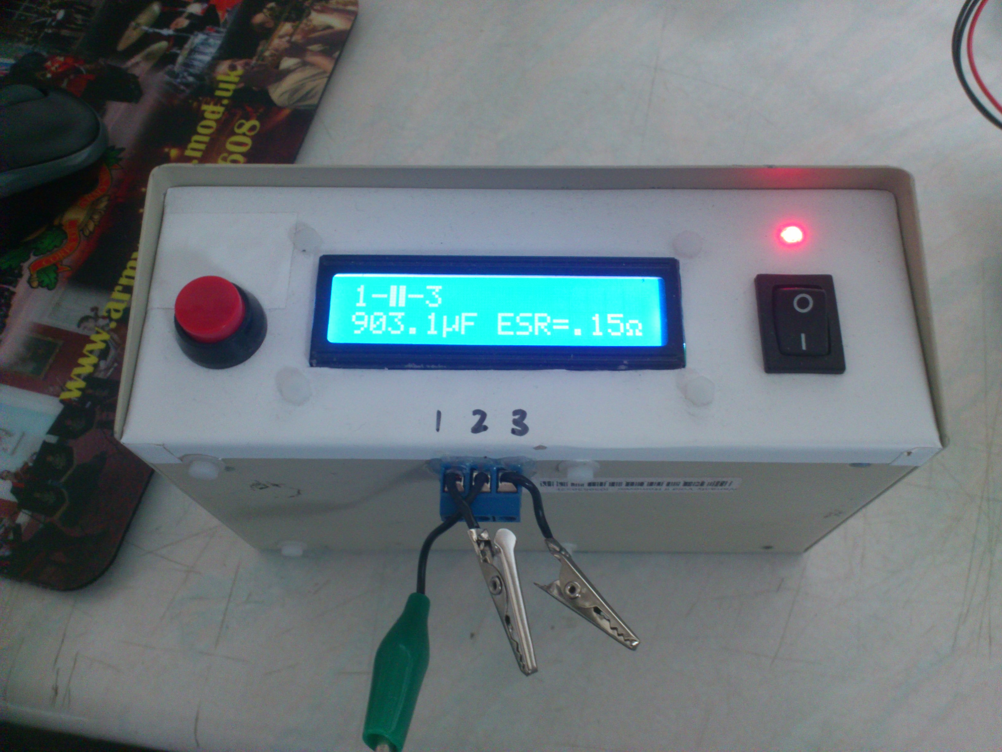

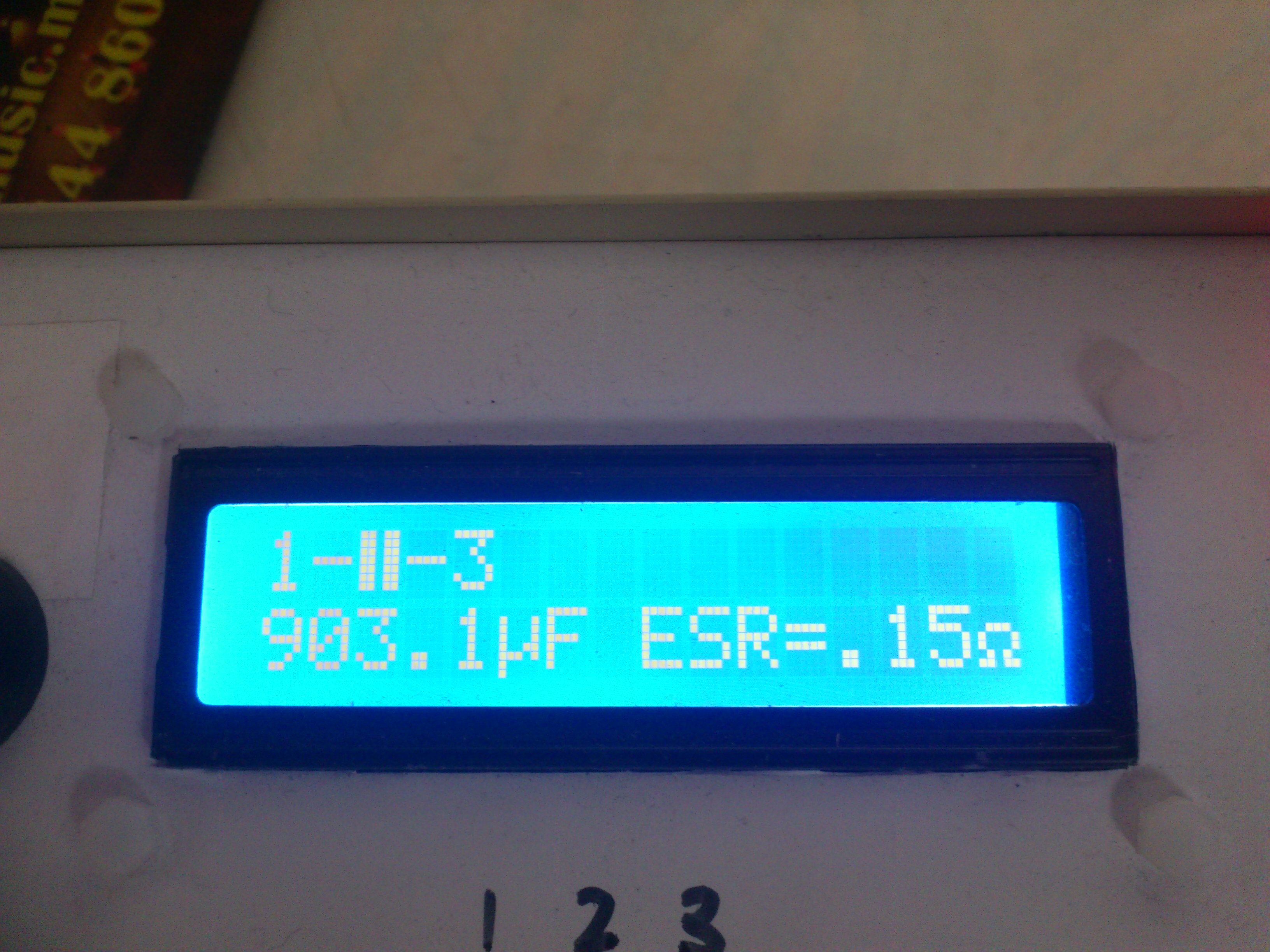

Hi
I have the Banggood Meter .. .. ..
I just attached it to a 16v 470uf attached to a radio circuit I'm looking at and see the pics, judge for yourself. The cap is new, just fitted !
S

Hi
Indeed, it does not exist such thing as "something good for nothing".
Bob Parker's Blue ESR kit cost some $80, however most of the cost goes to quality test leads and plastic box, I think.
Nope, you get what you pay for, I guess .. .. .
On the other hand, this thing is quite useful for standalone testing, but it doesn't like anything in circuit - weird and wonderful measurements !
