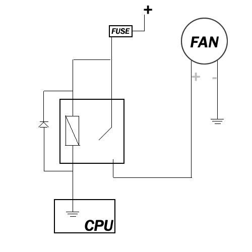

I have a car that used to have a mechanical fan but for milage and other reasons I put in an electric fan from a performance fan mfg.
Well... about 1000 miles after I installed it, it stopped working. I pulled it out and connected it directly to the battery to test and it just arc'd and sparked. Obviously broken.
I replaced with another of the same model and in no less then 100mi it did the exact same thing.
So, I sent both back to the mfg and they called and said the reason they broke was from 'excessive amperage'. Which I cant understand since the fan is only going to PULL want it wants from the battery no ?
I cant drive the car w/ no fan and i'm hessitant to put another fan in since I think I know what will happen. Also, I have never heard anything about this problem before. Niether has the mfg. So I'm guessing its wiring or the way I have it hooked up. Which looks like the pic below.
Also, the mfg says the fan draws ~11amp when on (but a little more right at turn on instance) but the company I got the fans from includes a 30amp fuse (which I used).
I'm confused. Both fans when bad w/o blowing the fuse. What the hell could be going on? Anyone have an ideas ?

I'm not an automotive expert but I've heard that transients on the +12 line can be fairly bad. Its possible that a spike damaged the fan coils causing the burnout. Fuses work fairly slowly so its possible that a short transient didn't put enough power into the fuse to damage it.

The fan is controlled by a pic. It reads in the coolant temp sensor and triggers a NPN transistor to connect the relay coil to ground. This is a proven working system. And since its on the control side of the relay, and the relay is only triggering when its supposed to.

Your diagram shows no protection for the fan at all. Now, if the fan is known to be rated for such nasty electrical environments, then it may be ok but if you are not sure, you really need some protection. Over stressing can drastically reduce its life. Also, it may have actually failed for an undiscovered reason and the excessive amperage is a result of the original failure. So because it experienced excessive amps doesnt mean that is the root cause failure.

Have you done some basic electrical tests on your car? eg, measuring the system voltage (if the regulator is blown, voltage will be too high). Or when you connected the fan to the battery, did you measure how much current it was drawing?
I'm wondering if maybe the ground has a poor connection... But I also think that would blow the fuse
No, that wouldn't normally blow a fuse - a poor connection would cause a lower current draw.

Exactly!, I suspect they are conning you - assuming you have quoted them correctly?. No one with even the slightest electrical knowledge would use the phrase 'excessive amperage', the correct term would be 'excessive current'.
I suggest you get back in touch with the manufacturer and ask for 'proper' details, not a load of made up rubbish!. If they claim it's caused by 'excessive current' then ask them why, electrical conditions on the car won't cause it, although excessive mechanical load on the motor would cause it to take excessive current - causing the motor to overheat and burn out.
Is it possible that the controller is starting and stopping the fan a LOT - causing it to draw the start-up current, stop again, draw the start-up current, with no rest (cool-down) time ?
I don't like the "too much current" idea - too much current must have been caused by :-
- too much voltage (Phasor's idea)
- too frequent starting causing overheating of the motor coils
- faulty manufacture (as you said - unlikely - but not totally impossibe, are they from the same batch?)
- stalling (fairly obvious - dead dog wedged through radiator ?!)
Could the fan be happier without the PIC controller (just wired to ignition switch - a bit crappy but it could (dis)prove an idea)?

Before going any Farther, Check the Battery Voltage, With the car Running at a reasonable RPM. It should Not Exceed 14.5 Volts. If it does you have a regulator problem and a definate cause for failure of the fan.
Also, Instead of using a Relay, why not use a Mosfet to Sink the negative lead of the fan to ground. Less Chance of Relay Chatter, or Contact Resistance Problems which may Cause Excessive Current.
