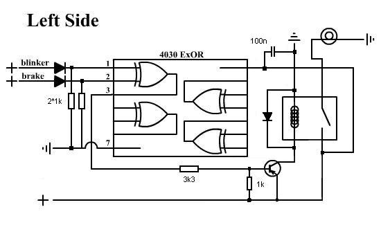

EXOR for brake
Sebi
Active Member
Add some components for proper work...
