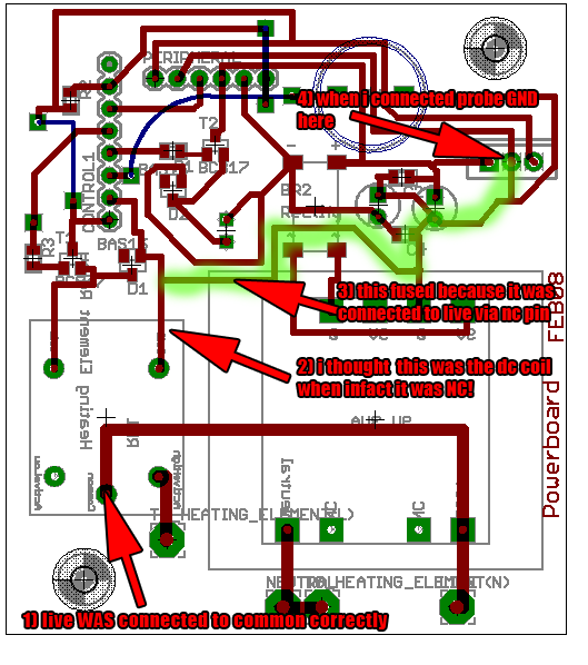

exploding traces.
Nigel Goodwin said:
Because it would take 30A or so to blow it, the PCB track fused at a much lower current.

Just rebuild the circuit, there is a good chance the transformer is not damaged as the PCB tracks acted as your fuse. However, you were lucky this time, had you handled the low voltage side of the board you could have been electrocuted. Hopefully, your first big bang scared the xxxx out of you as it did me and you will double check everything involving mains in the future. I had a very good friend who lost his life through a silly mistake like this.
The transformer is broken.
it did indeed scare me, but I had taken adequate measures to ensure safety and stayed well away from the board, touching no metal contacts. I treated the low voltage side as if it were high voltage:eek: , and used insulated connectors.
next time though, i will indeed check and recheck all connections to mains electric.
i was foolish to assume the layout of the relay pins:eek:

eblc1388 said:
@HerbertMunch,
The scope lead clip is earthed, did you touch this earthed clip to any point on circuit which has LIVE potential?
hi thanks for your concern.
please see the pic that i have included.
thanks
chris:D

kchriste said:
I think that your relay is wired wrong. It looks OK in the schematic, but on the PCB layout it appears that you've mixed up the coil connections with the NO and NC contacts!
A PCB layout program with schematic capture can prevent this type of error. It can save many hours of hand verifying the PCB with the schematic.

You would think so wouldnt you! im using eagle, but i created the device footprint from scratch!
