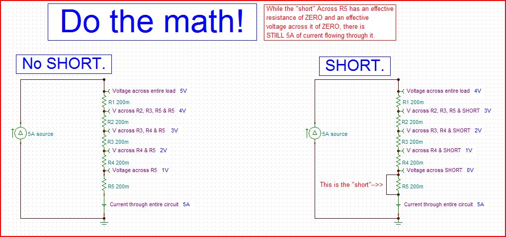

External Power supply current limit set to MAX amps to find SHORTS on a PCB
What kind of short are u talking about?
Why would it be in the millivolts?
Do you mean, measuring from VCC to ground on each IC chip and what component is connect to the VCC and ground rails?
So how do u know where the short is? there is NO voltage drop from VCC to ground on that component?
The techniques relies on there being some voltage drop along the power lines. It will be very small, which I why you need to measure millivolts or fractions of millivolts.
It is not measuring the voltage across the component or short circuit.
What you might not understand is that everything on the PCB, including the PCB itself is a component. The PCB is a parallel path. The traces have resistance, capacitance and inductance. That's just the way it is.

OPEN and SHORT are relative concepts. You might be better using OPEN PATH and THE SHORTEST PATH.
Nearly every thing from the PCB to the wires are "components". They have the basic properties of resistance, capacitance and inductance.
Let's try this again...
