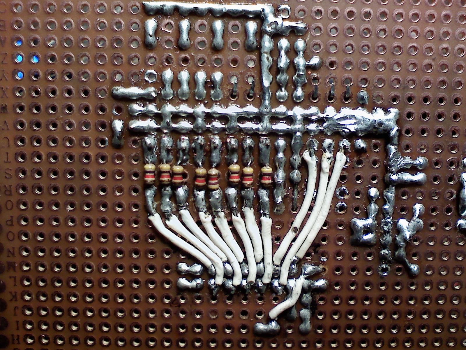

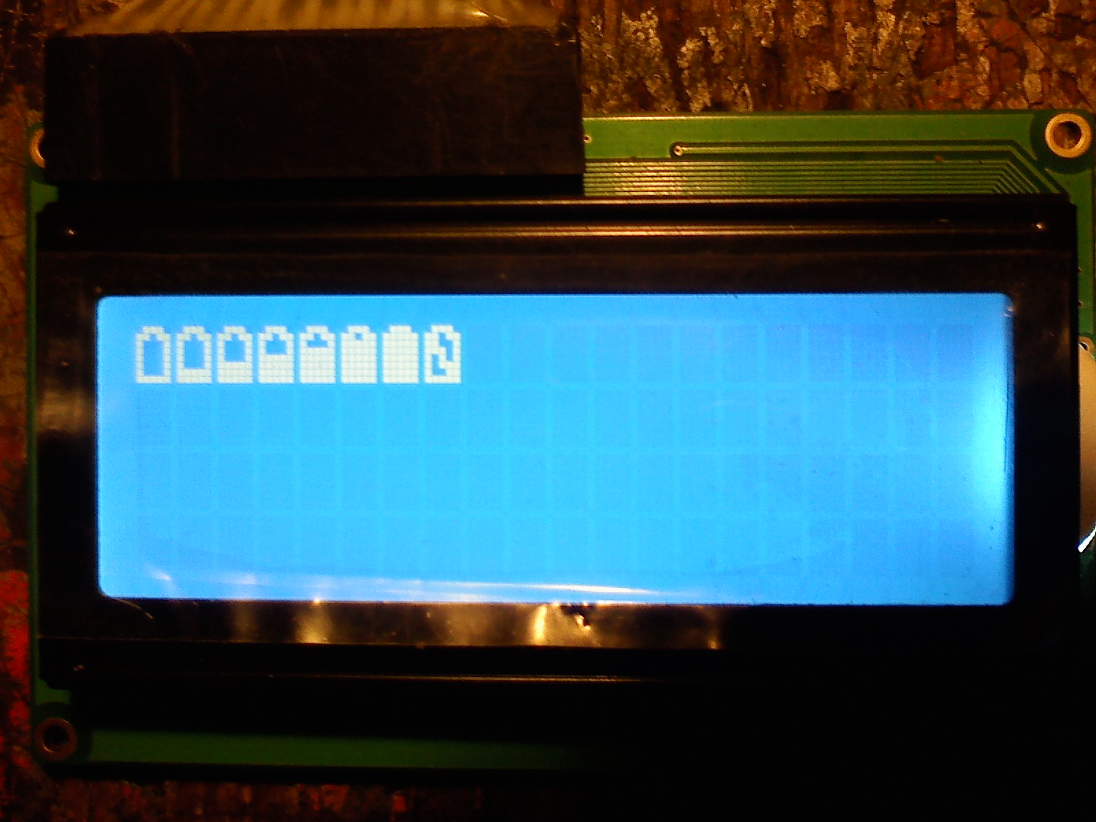

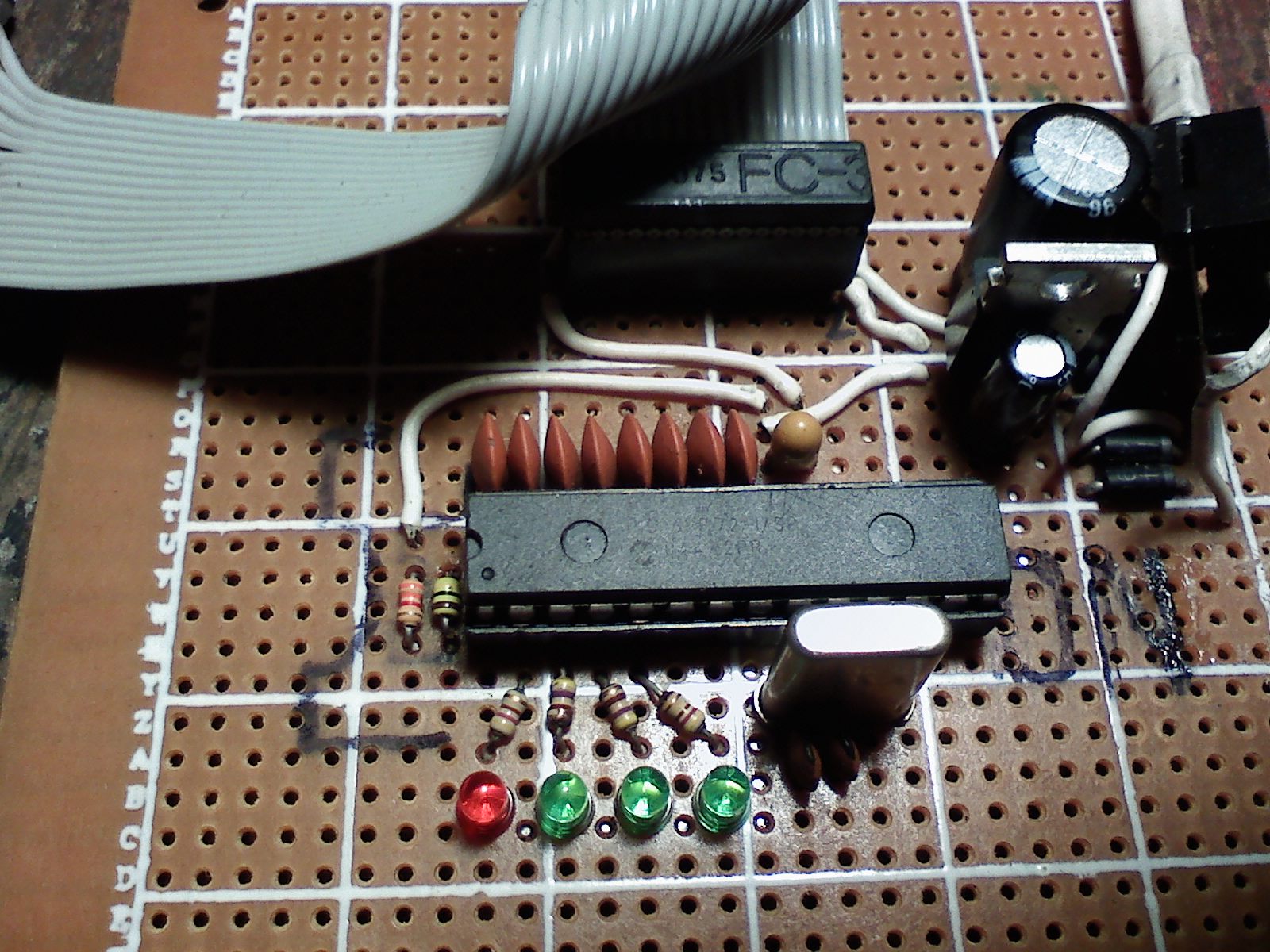

I have a cute little "interlock" routine now that I hope works. Just as the name implies, it is designed in such a way that you (mostly) can't do LCD/PORT operations without going through these routines, and there is no combination of calls to them that can lead to both devices being Low-Z simultaneously. I also have two simple checks and a "panic room" catch all that can be used independently should one be forced to bypass the interlock system. ...
Sounds like a clever solution. Congrats.
