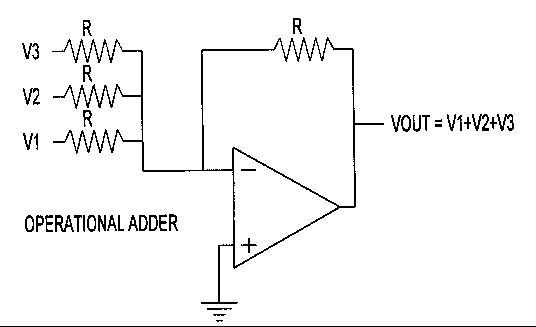

I had an idea for a very simple analogue calculator.
several variable resistors in series, each is turned to an ammount, the total resistance would be the sum of the three ammounts. Its pretty basic, but its something to fill my otherwise empty life :)
but, my only stumbling block is how to measure the overall resistance, without using a multimeter (which would defeat the point a bit)
i'm thinking either seven sigment displays, or an analogue ammeter, but i'm not sure how to 'invert' the current (under normal circumstances, the higher the resistance, the lower the current)
maybe it could be done with a voltmeter?
all suggestions welcome

It depends how far you want to go, the EPE was quite limited as I recall.
The technique with an analogue computer is to simulate the function you are trying to calculate, it's where many of the opamp circuits (mixers, integrators etc.) originally came from.
Because of the analogue way they work, you generally need to wire a number of different sections together - this is why analogue computers were usually provided with lots of plugs and sockets. With a digital computer you write a program which goes into memory, with an analogue one you actually construct a circuit which does what you want.
The operational adder:

Hi, again
I constructed the operational adder that you posted (a snake that can do maths, how comedy!), using input volatages of between 5v and 10v, and the voltage at the output was only around 80mV ?????
I has assumed that if all three input voltages were 5v, then the output would be 15v (5+5+5) ?
maybe i missinterpreted what you meant? :?
It would actually be -15V, because the circuit inverts, to correct it you would add another opamp as an inverter on the output. Obviously the output voltage is dependent on the supplies to the opamp, and it's capabilities. Just as with a digital adder you have to avoid overflow, with an analogue one you have to keep within the supply rails.
