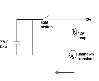

also is there any reason why the diagram i drew up (below) will not work? and if it won't... why not? and if it does... what kind of capacitor and transister should i use? thanks much.. still learning...

Can you check your diagram ... seems to me the switch will turn the light on but it will then fade out as the capacitor charges (in series with the resistor). Opening the switch will instantly kill the light.
This isn't quite what was wanted ?

Thanks, Mechie! I've forgot the fade-out function. This cct. can work.

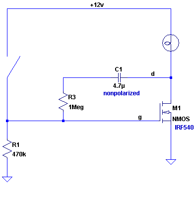

Here's another circuit you can try. You can choose another MOSFET, so long as it has low enough ON resistance and can handle the current. If your dome light actually connects to ground instead of +12v (do you know for sure?), you can use a p-channel MOSFET and turn the circuit upside down.
In this circuit, the lamp voltage turns off with a linear ramp waveform, while in Sebi's, it will be an exponential waveform. Due to the nonlinear characteristics of lamps, I'm not sure which is better.
