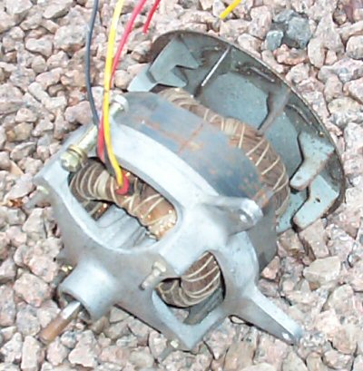

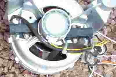

Sorry for not answering sooner but been a bit busy round the house.
There are two motor's i have both off washing machines, one has a lablewith some information the other has nothing. The one without any details does not have any brushes orcannot see any and the wires to power it go stright into the windings. The other motor is from italy and is made by SOLE Type 20584 024, AC-EL, CL. B/F, 220/240V 50Hz 300/14000 Rpm.
50Hz? that sounds like a AC motor to me? i just went and tested it with a 15Amp fuse (last one blew) and reved up then shut it self off think i just blew one of the windings :roll: plus all the lights in the house went dull when i tested it. I'm thinking we'll forget about that motor :lol:
And were left with the one without any writing on it and wires going striaght into the windings.
To clear up about the air conditioning - there is not its just a fan attached to this motor behind some (alot) or radiators to blowhot air into my dads home built swimming pool. No coolingwill take place.
The way i've designed it, a room thermostat controls a zone valve and motor's to blow hot air out of ducting in the floor. when the temperature is reacher the thermostat turns the live wire off and fans stop no more hot waterallowed into the radiators.
Not sure if i will have to use a relay for the fan motors inclueding the one im trying to get working now there are 2 other tiny motors about 1 Amp each.
The point about a dimmer switch seems great, but would you put it before the bridge rectifier to lower the voltage or would youput it after in which case will it work in a DC circuit?
Cheers everyone for replying :)

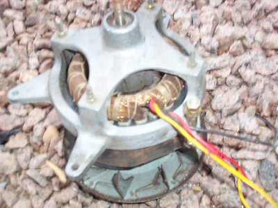

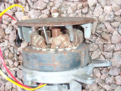

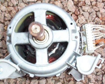

Motor im using is image4, image5 and image6 i.e the DC one without all the wires comming off it

Hi DeDogs,
Images 4, 5, & 6 look like a shaded pole AC motor to me.
If they are, you should have two identical windings
with a common wire.
Check that with a meter and note the common wire.
It will probably be a bit like the diag below,
one switch for one way, other for the other way.
You will need a cap to run it, hard to say what size
over ten mfds, maybe twenty, depends on windings.
John :)

Hi DeDog,
Yes, you will need the cap to start the motor running,
but it can be run on one winding if you spin it manually
(not recommended)
It will take more current when its not turning.
With the cap in circuit, both windings contribute to
running the motor, the cap provides a phase shift to
give direction to the motor.
The cap has to be 'Non Polarised'
The cap must not be marked red or pos on any terminal.
The cap must not be an electrolytic.
Motor capacitors are typically roughly a quarter the
size of the motor, maybe a fifth these days.
I would guess at maybe 12 MFDs for that motor.
Sorry, i don't know how to tell the proper value easily.
Maybe someone else could give an opinion?
Somewhere between 10 and 20 should be ok.
That diag is for running either way,
here is one for only one direction.
Best of luck with it, John :)
