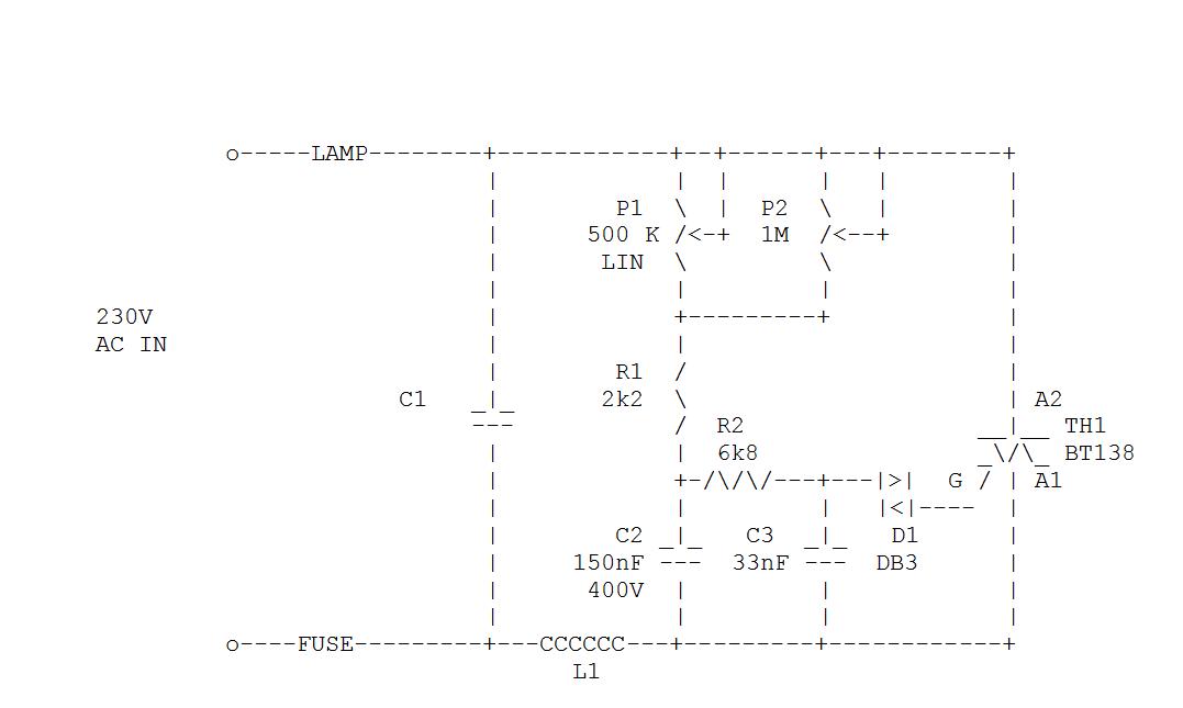

When dimmer is at low speeds, you can hear a noise in the fan. I think I need to add a series choke and a parallel capacitor like the attached file dim1.jpg but I do not know how to calculate their values. Could you please give me an idea?

Well, I've done it myself and it sort of works, but the motor can be noisy due to the pulses from the dimmer. I don't know if there's much you can do to quiet that noise although a choke and capacitor might help.
Raise the chopping frequency. At 50Hz or 60Hz (AC Phase control), the LC filter components will be bigger than the motor...

That's because you are stalling it, and it doesn't like that. It can also make it get hot. I believe most modern ceiling fans use a split capacitor AC induction motor and speed is adjusted by switching in a different value of capacitor driving the secondary winding.

Try a 1.5 uF 400 Volts capacitor.
I have successfully used those in the standard 3 speed fan to make it 6 speed and obtain hereby the 3 low speeds which are perfect for a hot summers night when you don't want too much draught when reading a newspaper.
A bit of trial and error is needed here.
Don't even bother with a choke. Put a 1.5 µF Cap. in series with the motor and a mains rated bypass switch in parrallell with it.

I would like to see the circuit that actually slows down the fan without making a lot of smoke or noise. It seems that it would take an awful lot of filtering to remove the harmonics which are responsible for the additional noise, and if that were applied to the original circuit, wouldn't the currents flowing in the high Q resonant circuit prevent the triac from commutating off?

As we've said, this isn't the way you speed control a fan - they don't use universal motors, and aren't suitable for phase control, filters or otherwise.
