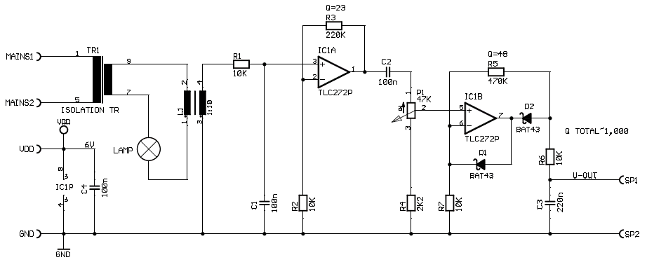

Hi ranariaz,

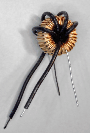

here is a schematic. It uses a current transformer being made of a toroidal core inductor as normally used in dimmer circuits. Use three to four windings of sufficient diameter (for lowest voltage drop) to make the primary winding being connected in series with the lamp.
The two stage amplifier following the tranformer has a total amplification of about 1,000:1, adjustable via P1. The amplified AC is then rectified and charges output capacitor C3 with a time constant of 50ms.
As long as the lamp is working properly the output voltage is high. If the lamp circuit is interrupted is goes low.
Refer to the photo to make a current transformer. The black cable is connected in series with the lamp.

That is a neat way of making a current transformer. In the circuit, I think the diodes are the wrong way round.
However, as it is a current transformer, the load impedance on it should be low, or it will saturate and heat up. I realise that it is probably not a big issue on such a small transformer, but keeping load impedance low is common practice on current transformers.
It is also easier to get the correct calibration. At the moment you have transformer with a current input and a voltage output, so the ratio depends on the inductance (and frequency) as well as the turns ratio. If the output is current, the current ratio only depends on the turns ratio.
