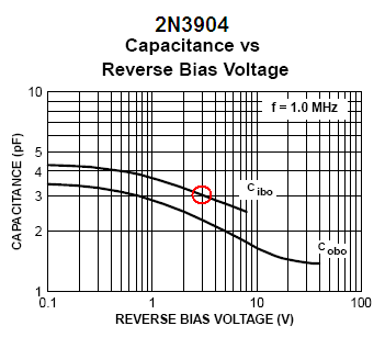

He is using the 2N3904 transistors as a varactor vari-cap diode. How can he possibly measure only 3pF???
Isn't 3pF about the capacitance between the wings of a bee?
His connecting wires must have at least 20pF between them that changes whenever someone walks by.
Good point. I guess the capacitance plot would also look at lot different up in the commercial broadcast bands. This is probably the times you'd need some super-expensive RLC meter.
The only difference that frequency would make is in the inductance of the connecting wires at high frequencies. The factory uses only 1Mhz when testing capacitance to avoid the inductance of their test jig from affecting the results.
Just think about how high is the inductance of MStechca's long wires. The transistor-varactor will resonate with them and not be a capacitor anymore. Then he thinks the transistors are baaaad.
Maybe the leads on his "bad" transistors have a different inductance from the other brand he was using. They are guaranteed to operate as ordinary transistors aren't they?

The capacitance of some 2N3904 transistors is too low to use as a varactor diode. The minimum capacitance isn't guaranteed. You wouldn't have this problem if you used a diode that is made to be and is guaranteed to be a varactor diode.

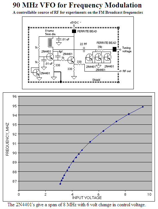

As I showed before, a 2N4401 transistor has much more capacitance with a greater range and I showed a circuit using them. Maybe most of them would work as a varactor diode.
MStechca is re-inventing the wheel. This circuit uses three 2N4401 transistors in parallel to get enough capacitance for an 8Mhz range:
