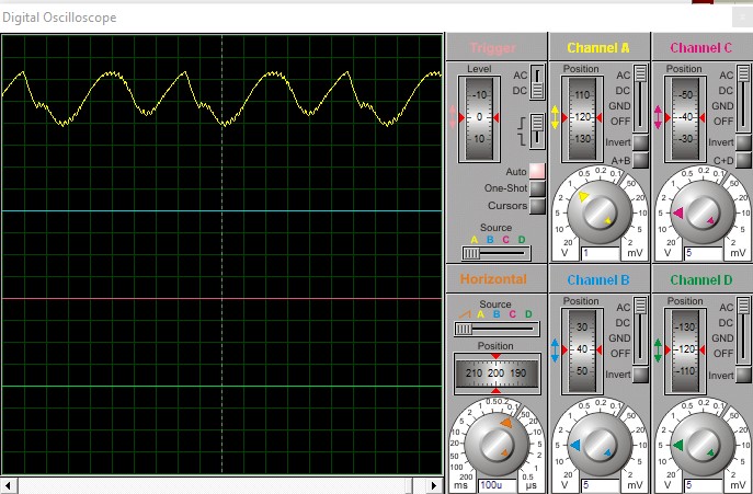

Here is your sine wave in Proteus circa 1khz.... This is with a simple filter 330Ω and .33μf..

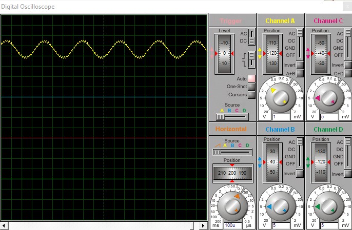

Here is the same 1khz wave form using Roman Blacks "Harmonized" sine table..
C:
const unsigned char sine[50] = {52,57,62,66,70,74,77,80,82,84,85,86,86,
                                   86,85,83,81,78,75,72,69,65,61,56,52,
                                48,44,39,35,31,28,25,22,19,17,15,14,14,
                                   14,15,16,18,20,23,26,30,34,38,43,48};
The distortion is purely the table...
