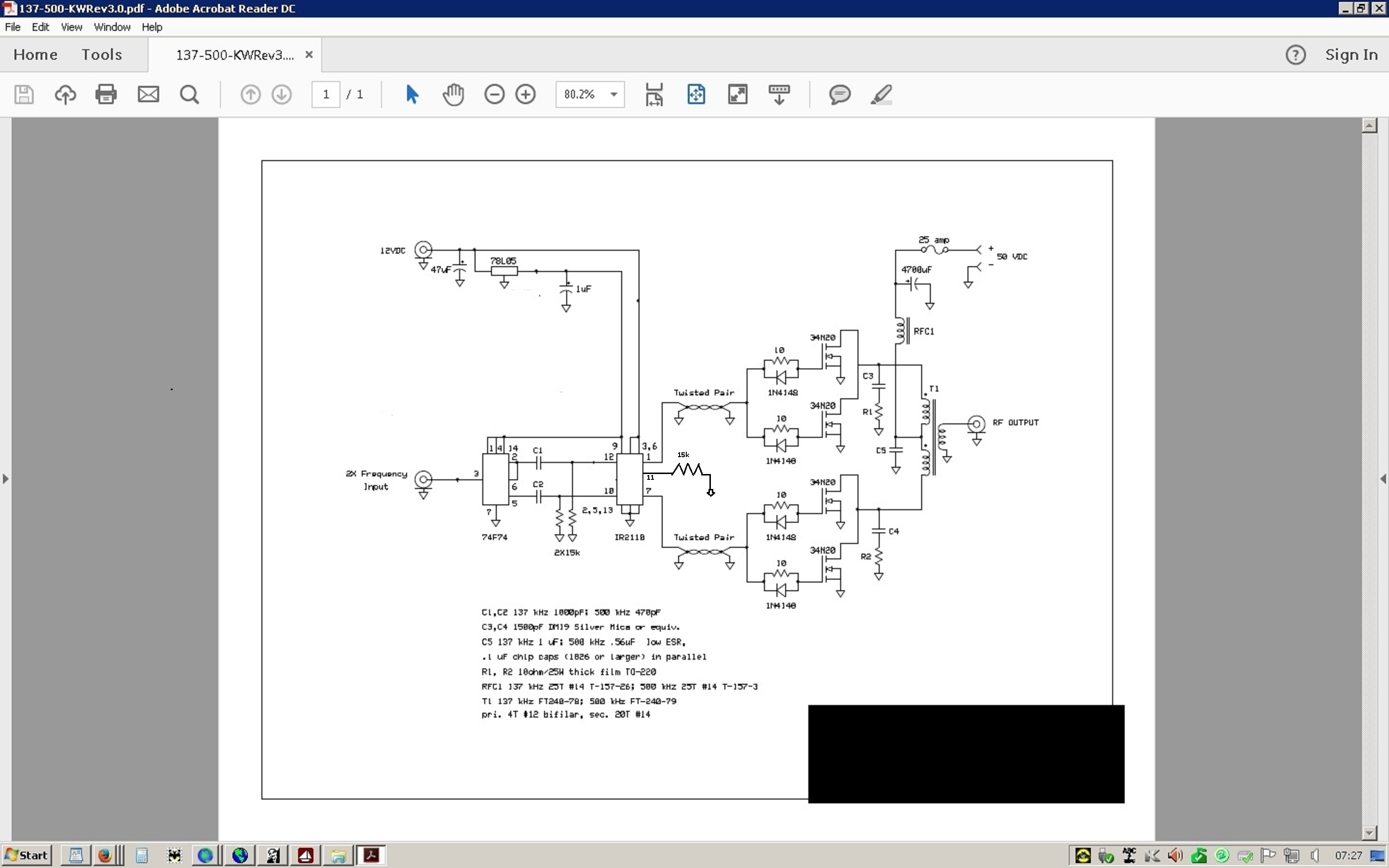

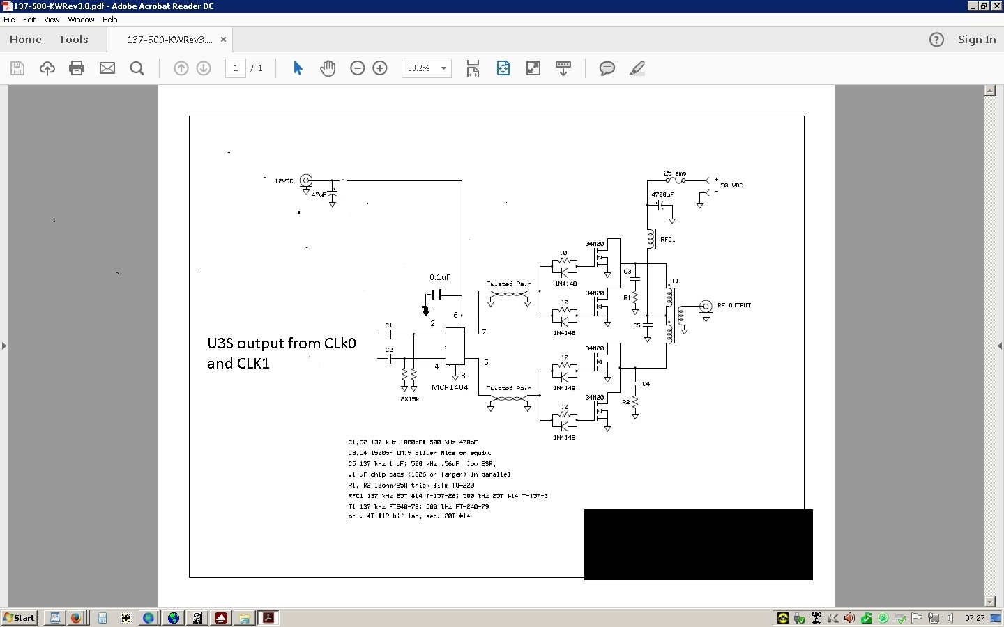

2 schematics hopefully attached, one using IR2110 and the other using MCP1404 thanks kubeek.

Actually, what I said is only true for the IR2110s. Your schematics are all funky and seem to be missing parts required for the IR2110 I don't know what's going on (I see no bootstrap caps or diodes in the schematic you provided. You can see what they look like in the part datasheet on page 1: it's the diode and the cap between Vs and Bs) , but in the way the IR2110 is used, what I said is true.
The MCP1404 does not seem to allow for high-side gate drive (no provisions for a boostrap diode or capacitor) so I don't know why you are seeing falling gate voltages with this one.

EDIT: I think I see why your schematic seems to be missing components and is funky to me. A push-pull circuit doesn't have any gates that have a floating sources so they don't need the boostrap supplies which is why I see no bootstrap caps or diodes. The MCP1404 was never able to provide this floating gate drive so it was just used as is while the IR2110s just had it's high-side supply pins fed directly to 12V rather than through a bootstrap cap and diode since the floating gate drive was not needed.

I suspect what's happening is the AC coupling capacitors on the inputs to your driver ICs are charging up the longer the gate is on for which causes the input to slowly approach ground the longer it is on for which slowly turns off your FETs. Do you need to AC couple these inputs? What happens if you just short across them? If you just apply a direct 3.3V or 5V to these inputs you should see no voltage sag on the gate while it is on.

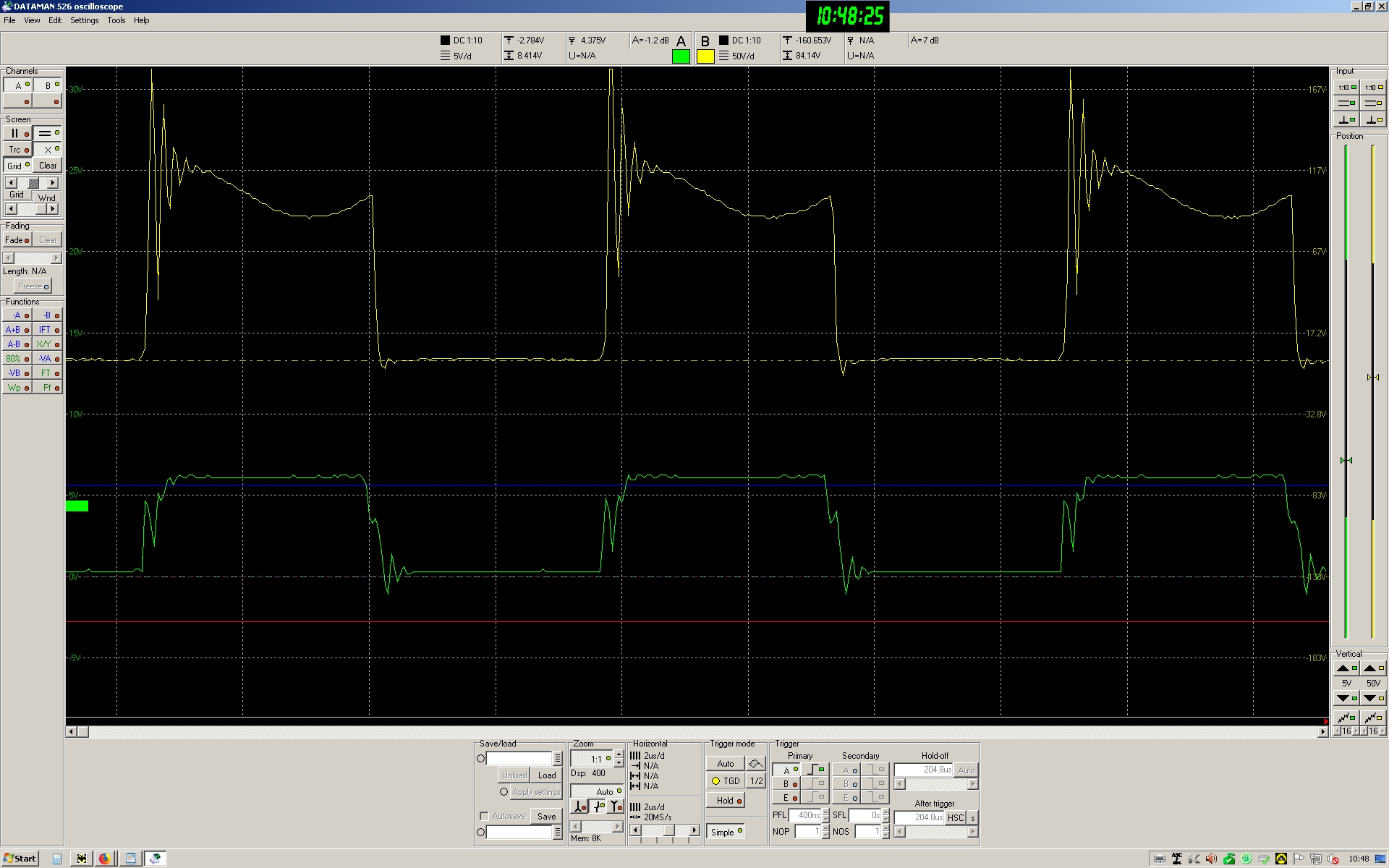

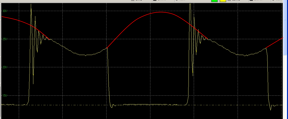

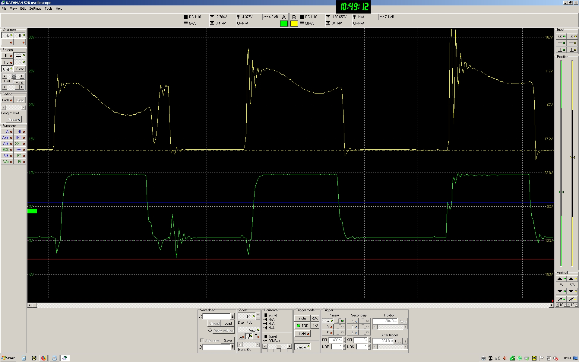

OK, let me post three scope captures. Bottom traces are gate voltage waveforms at the actual FET gate pin. X10 probes.
Upper traces are drain waveforms at the drain pin itself of the FET.
File names should be self explanatory, but basically the three waveforms are at 9V (works great), 6.8V (waveforms noisy) and 11.7V (waveforms have gone to pot, only saving grace is current limiting on the supply stopping cross conductance blowing a FET) the 9V, 6.8V and 11.7V are measured at pin 6 of the MCP1404 and it comes from a quality linear regulated bench supply and has good decoupling at the pin 6 of the IC itself.

Ok, my worry is these caps are there to stop any chance of a FET being held on if the CLK0 or CLK1 outputs of the Si5351A synthesizer are held high. I need to check this. What is the point of all this you may ask? ;) Well, I am trying to learn and the designer of the exciter for this amp, a gizmo called a U3S by QRP Labs has issued a new firmware that allows one to have 180 degree inverted outputs from CLK0 and CLK1 of the Si5351A chip. This would allow me to simplify the amp and get rid of the 74F74 flip flop, which needs a X2 frequency from the U3S as it halves the frequency as it divides the phase. My issues have been this varying Vcc voltage effect on the gate drive voltage, and getting enough swing from the Si5351A synthesizer chip to drive the IR2110 properly. The MCP1404 seems happy with less swing.
Finally, I have concerns as to whether there is any inbuilt "dead time" on an MCP1404? I know there is on the IR2110 but that seems to want more drive than the Si5351A can provide. I am at the extreme of my comfort zone here, but love fiddling and would like to simplify this as much as possible. Thank you very much for your help here, it's much appreciated!
I note you have no connection to pin 5 of the IR2110. With your circuit configuration you may need to ground pin 5 to get consistent results.
C1 and C2 will drive pins 10 and 12 negative, beyond their allowable limit (Vss-0.3). That may lead to malfunction of the IC.

There is the issue in communication. The gate waveforms are the lower traces. The drain waveforms are the upper traces that you are asking about which are going nasty. I'll get back to you later but it's probably parasitics causing the ringing though I'm not sure why they would get worse at lower voltages rather than just higher voltages (with higher voltage not . Chat button is a button in the top bar.

Looking at the schematics and scope pictures, I think the 12V has serious ripple on it. Caused by a lack of capacitors on the 12V at the IC. There needs to be a 0.01 to 0.1uF cap at the IC and about 100uF high current cap some where near the IC.
This looks like a RF project, where two feet of wire going to a supply will act like an inductor. Some wire and a 0.1uF cap can resonate at the transmitting frequency and cause strange problems.
