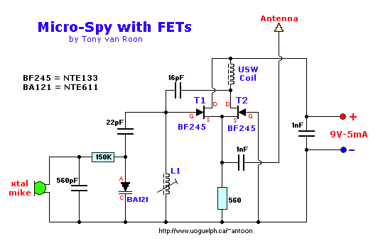

Hello guys,
I wanna know your idea about the bellow circuit which I want to make?
As you see it uses 2 N-Channel JFET transistors. I never have built a FM transmitter with FETs so don't know how good the bellow circuit will work finally?

It uses an old crystal microphone. Where will you find one today?
If you use a modern electret mic then it will need a preamp to drive the vari-cap diode.

What is your idea about the main circuit? What about its range?
5mA x 9V= only 45mW. Its range is 10m to a cheap radio, 20m to a clock radio and across the street to a very sensitive home stereo or car radio.
It doesn't have pre-emphasis (treble audio frequencies boost) like FM radio stations have so it will sound muffled on an FM radio (they all have de-emphasis (treble audio frequencies cut).
