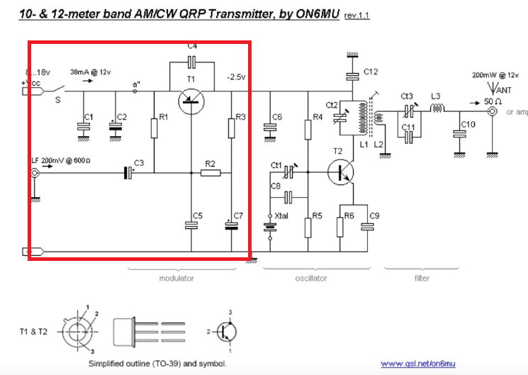

Like the modulator I did build a while ago which does output an amplitude modulated signal:
That looks like the basis of a balanced modulator, you are likely to get a double sideband supressed carrier signal out of that, rather than a correct amplitude modulated carrier.
To modulate your oscillator, I suggest a method of varing the supply voltage as per the circuit which you showed earlier:
I have highlighted in red the part of the circuit which is intended to vary the supply voltage to the oscillator.
However, I am not convinced that this particular circuit will work very well.
There are circuits which could work better.

I like the first circuit at #11, I feel like I can replace the crystal oscillator with the one I made. I tried changing supply voltage of the oscillator to see what happens, it seems like it can be done to get AM modulation.

I did make it work.
I used the first schematic from #11 but instead of crystal oscillator I used the one I made. I seperated the oscillator power and connected a 6V linear voltage regualtor to it to feed it separately to decrease its output voltage. I had two small inductors from a CRT TV that had too much inductance when I used one of them but two in parallel comes up as 25uH which according to expalation of the schematic is perfect. Adding tank capacitor across it around 30pF according to the graph did only decrease output voltage so I ignored the 30pF capacitor. I used single stage bjt amplifier for amplifying my phone jack output and used bypass capacitors to increase gain just enough to have some what ideal modulation. I will draw the whole diagram. I still did not get close to the voltage I simulated with LTspice. I guess my ghetto hand work created a lot of stray capacitances. With random alligator cable as antenna, range is less than 5 meters so I guess it is not a electromagnetic hazard. Frequency that it oscillates is around 1.2Mhz. I am thinking of cutting the excess ferrite rod to decrease inductance a little to increase freq. Electret mic required more gain than I thought and I wasn't able to get it with simple common source amplifiers so I gave up on it, it is not connected to anywhere.

I will note that for future builds. What do you think about the lower than expected performance of this transmitter. I wonder if the small torroid inductors have bad Q factor or something like that that makes them unsuitable for this application. I also noticed that I wasn't able to reach %100 modulation with 2V peak to peak input signal. There is something that is causing the modulation to be weak and transmitter to be under powered. I am not sure if it is worth investigating.
I actually noticed that oscilloscope probe is loading down the signal quite a lot. So simulated 30V peaks vs measured 10V may make sense. Also probe is probably adding some capacitance as well. So I added the 30p capacitor to LC circuit. I used my laptop as sound source since it can get more output voltage and that way I was able to get close to %100 modulation and volume output from radio dramatically increased.
