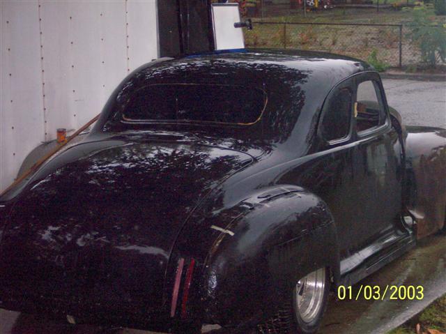

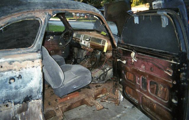

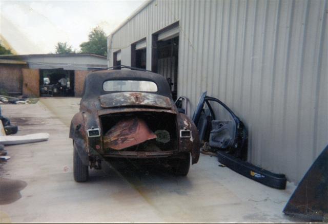

Heres a couple old pics of the 48 to see what I'm doing....Can you guess why they call me the "deadbody" man?????
